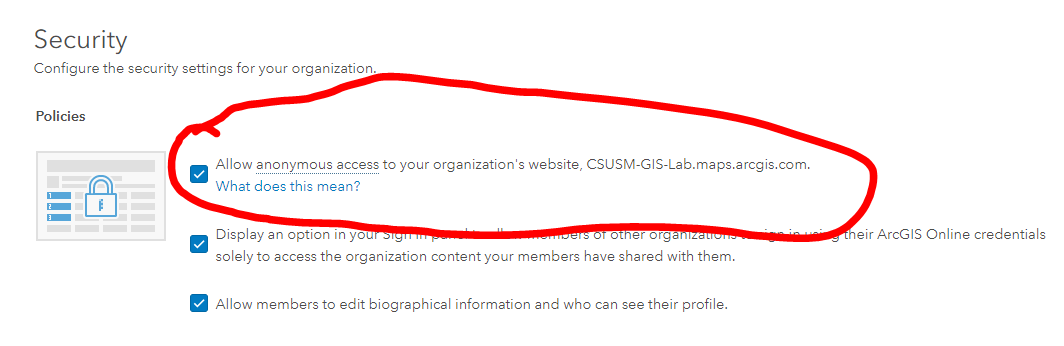

Security settings for our org should be set correctly:
