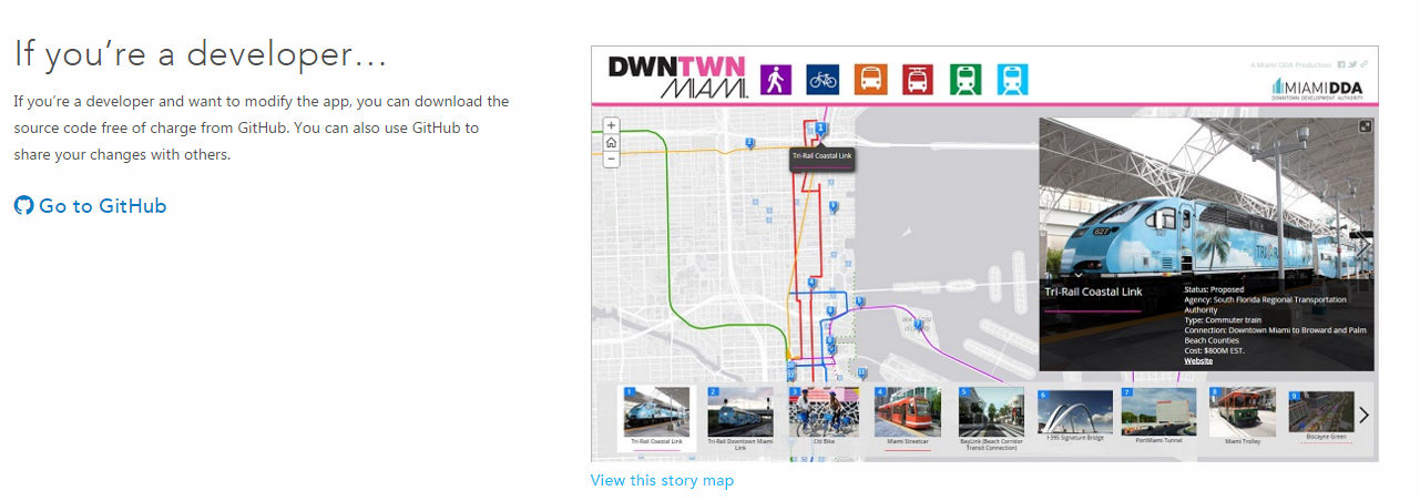

All of the StoryMaps application are downloadable. You can access them from the StoryMaps apps page, choose your app, click Learn more and scroll down the page to it's bottom to get a link to GitHub.
You can also find them directly from this GitHub website.
The process to deploy an application is documented on the individual GitHub repositories.
