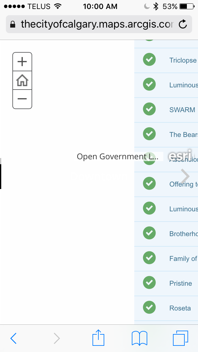

Currently I am working on creating a Shortlist Story Map (beta version) and have found that when I login to my map on my iPhone (both Chrome and Safari) the map is not working very efficiently.  I understand there was to be a fix for this in December 2016 if you are self hosting the code.  Will the update apply to the hosted app on ArcGIS Online at any point?  If not, how come?

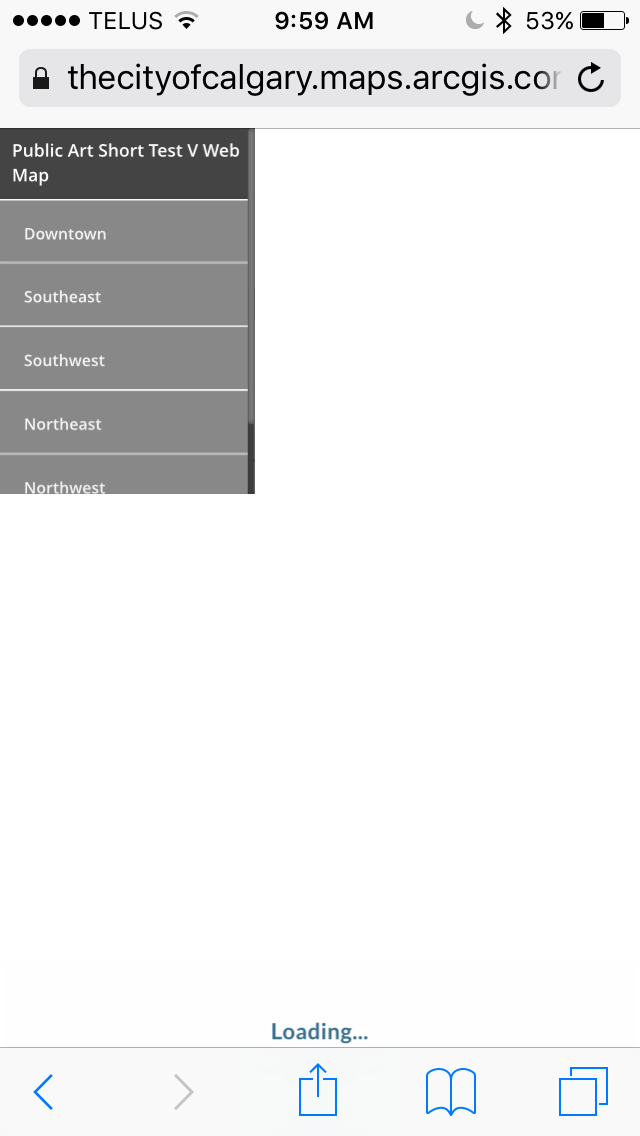

As you can see on image one, the main menu is only appearing on a quarter of my page.
The first tab, "Downtown", does not work.  the map is not appearing and a list of the features is appearing on the right side.

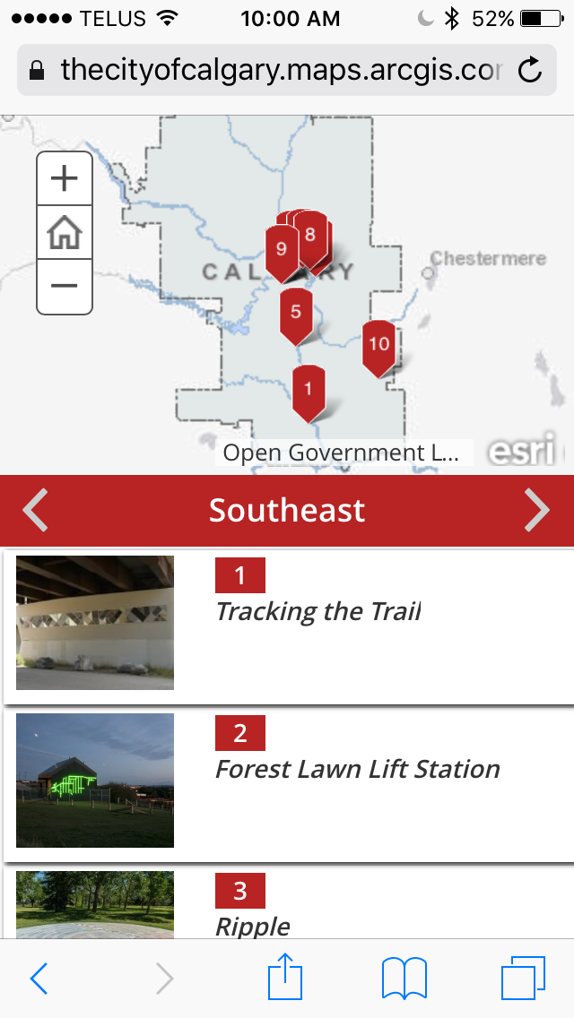

The second tab, "Southeast", works.
The third & fifth tab work the same as the first tab did, map is not appearing and a list of the features is appearing on the right side.
The fourth tab, like the second tab, works fine.
