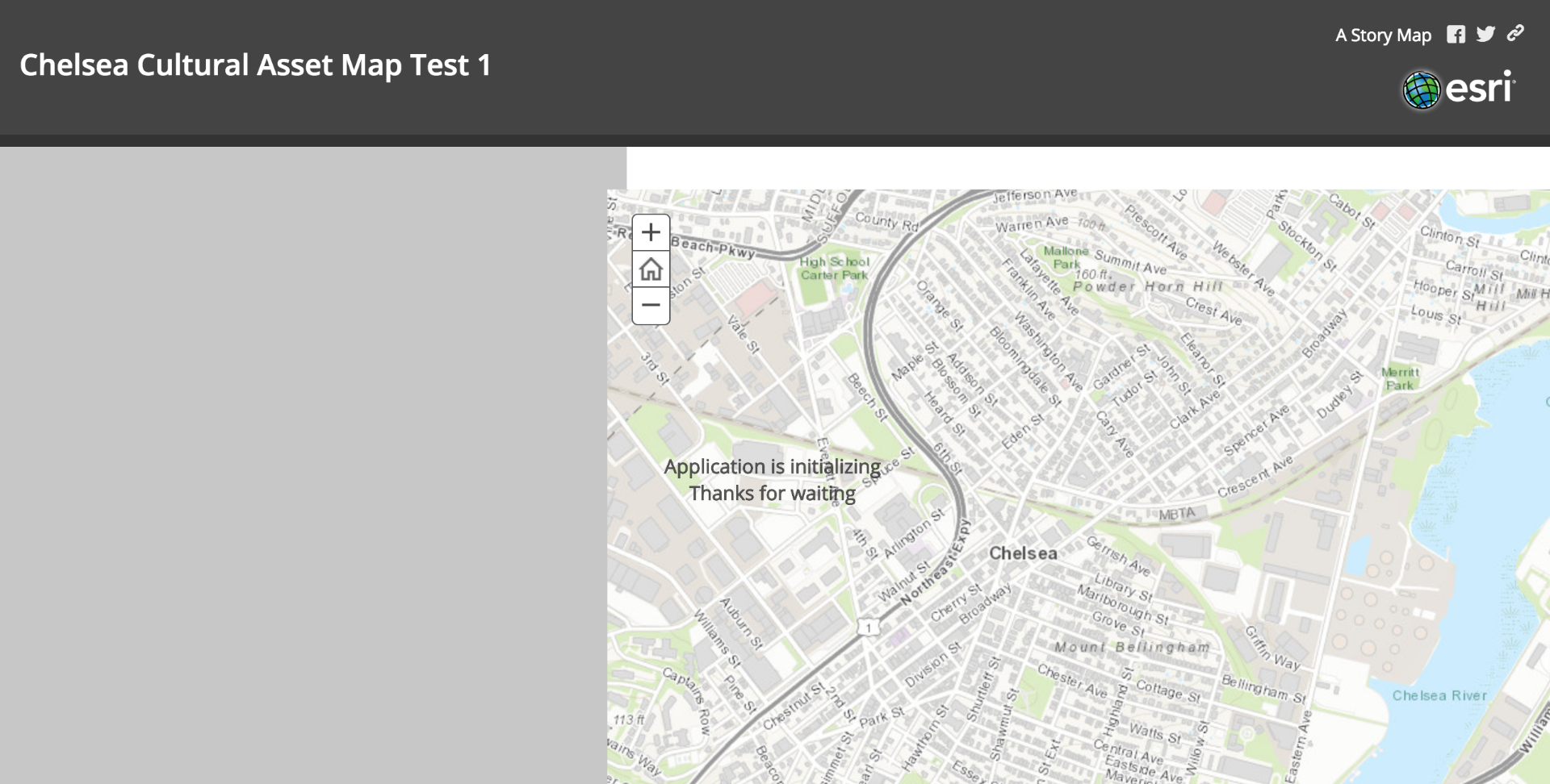

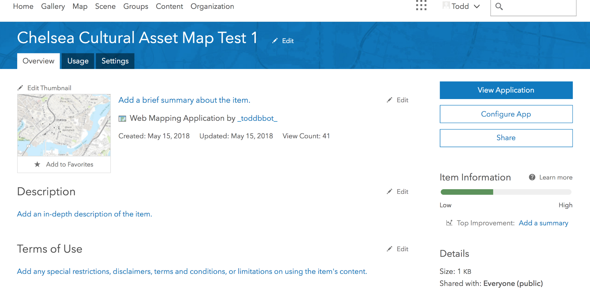

Hi, I'm trying to publish a Shortlist Story Map using an existing Web Map "as is." The application displays fine when I access it via my content page by clicking "view application":
However, when I'm not logged in, the applications behaves erratically. Sometimes the application displays fully. Sometime only some tabs display. Most often the application never finishes initializing:
The web application is public and accessible here. The underlying web map is also public, as is the supporting feature layer, whose definition is here.
