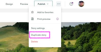

@RandyMcGregor3 - Yes, the ability to duplicate a story was added to ArcGIS StoryMaps back in April 2020. You can duplicate a story (or collection or theme) in the builder from the ... menu at the top right, or from the card view on your My Projects page.
For more information see the FAQ here.
Owen Evans
RandyMcGregor3
Thanks! That did it.
