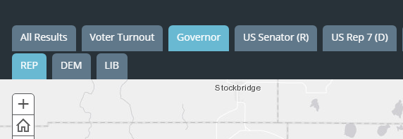

Thanks for the resources Owen. We love this capability. However, I'm hoping to take it one step further.  I need to have 34 tabs within our storymap. I've done it before using just numbers instead of the text in the tabs, but that's less user friendly, so I was hoping to embed another Series storymap in some of the tabs. Like this:
We have another website with the tabular election results, with links to view each race as a map in the storymap. Normally we just have the one level of story map and can make unique URLs to each race, but now since we have so many races to map, I was hoping to be able to group them and navigate directly to Governor>Dem etc.

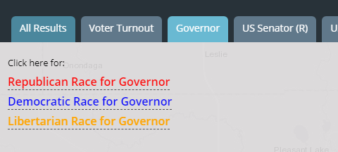

I thought more about the story action route, and I think that will reduce my workload a lot. Instead of another storymap within the tab, I'll put story action links to change the visible layers on the map. While I still can't navigate directly to Governor>Democratic from an external site, this is a much less complex construction. Thanks!

It turned out well! Here's the story map: August 2018 Election Results. It's just test data in there for now, and the popup links won't work until the actual election. I also found that editing the JSON via ArcGIS Online Assistant was a valuable time saver when formatting the popups for these 60ish layers.
