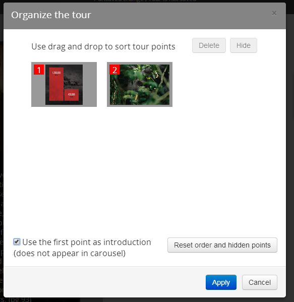

Your issue with the first image not appearing is not a web server issue. You have enabled the option to use the first point as an introduction slide (the first point isn't present on the Map and user can't get back to that point once you start to navigate the tour) and the picture of that slide is not valid.
To fix it open the builder, click the Intro button and then Change Media
You can disable that option through the Organize dialog.

Thanks for the explanation: So I could resolve the issue with the first image not appearing.
