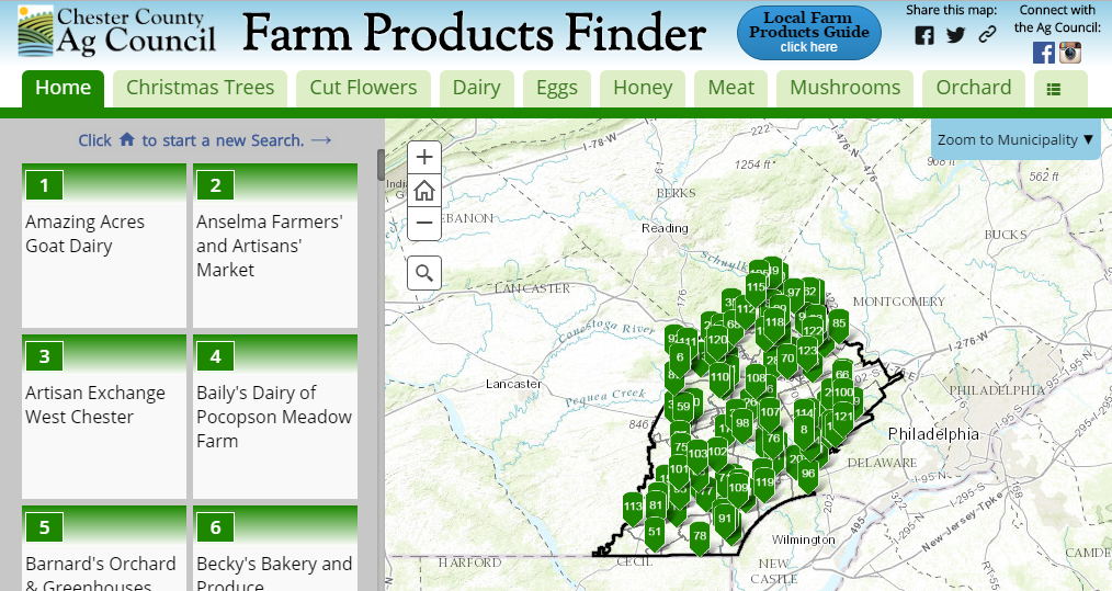

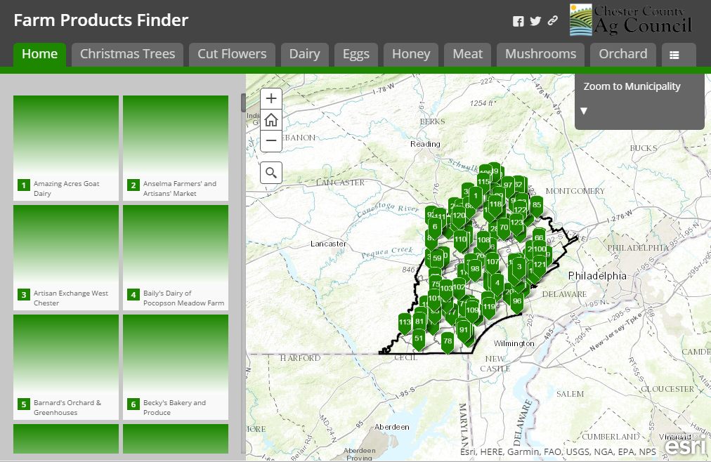

Uncustomized: http://chesco.maps.arcgis.com/apps/Shortlist/index.html?appid=30253a230e51436b99f20f81e8134562
Uncustomized version
Customized: http://www.chescoplanning.org/adc/farmfinder/
Customized version
