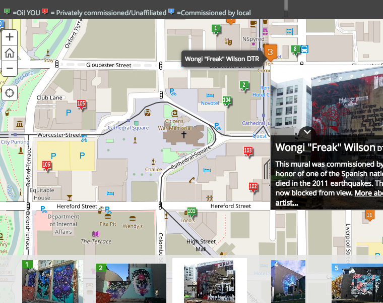

 I've recently added a fifth color to the markers in my maptour. The markers look fine, but the the background color behind the number of the thumbnail photos in the carousel aren't showing for the new colour, orange. I went in to maptour-config.css and changed what I think this thread was suggesting.
you can change the font-color in the carousel for each class in the maptour-min.css.
For example to change the font color for class 1, add:
#organizePopup .number-class1{background-color:#003d00;color:#YOURCOLORHERE}
I have a link to my repo here, hopefully someone can take a look? my maptour repo
Snippet of what I changed here
.numberLabel{background-color:red;width:20px;height:20px;position:absolute;top:5px;left:5px;text-align:center;color:#fff}#organizePopup .number-blue{background-color:#1880f3}#organizePopup .number-red{background-color:red}#organizePopup .number-green{background-color:#369A22}#organizePopup .number-purple{background-color:#8A26FD}#organizePopup .number-orange{background-color:#e67e22}#organizePopup
Cheers, Lindsay (screenshot of the issue below)orange is missing from the thumbnails

A couple of things. In your screenshot, it looks like the orange is showing up. Is this not what is supposed to happen? Also, this may make no difference, but have you tried capitalizing all of the letters (to make it #E67E22)?
lindsayc
Deactivated User
Hi Adrian,
I've changed it to #E67E22, but no change.
Below the boxes in red are what I am referring to. See 1 and 2? They have a green background like their markers on the map. 3, 4, and 5, don't have orange backgrounds on the thumbnails, but should.
Let me know if you have any ideas or if you figure it out you can send through changes to the repo.
AdrianWelsh
MVP Honored Contributor
Oh, I get it now. That makes more sense. I am guessing the changing of the color must happen somewhere else which is why it isn't being picked up.

good point Adrian, that the change must be made somewhere else in the script. I did a search of one of the colors and then based off of that looked for where a fifth colour was missing, copy and pasted a line to make a fifth one and substituted in the color code for orange. all good now!
