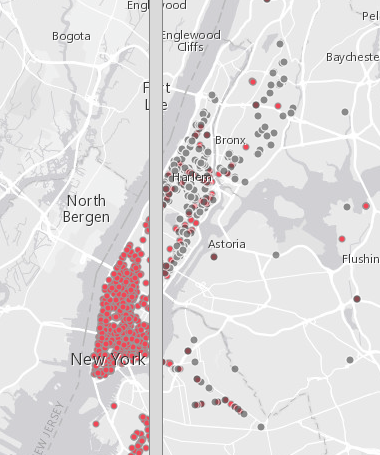

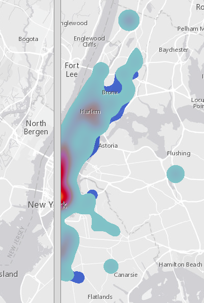

I am working on a map with two layers both styling in heat map, hoping to get the swipe to compare one heat map with another. However, no matter which one I chose to be swiped, the two layers will appear/disappear together.
In contrast, when I changed the style to individual points, the swipe works fine.
Probably create two separate maps and having each contains one heat map could solve it. But it seems really a waste. Any suggestion? I am using the swipe template hosted in ArcGIS Online without any change.

Hi Fan -- I believe that for technical reasons the way heatmaps are rendered in a web browser is that all heatmap layers in a map are added to the same client-side layer, so you're not able to swipe them individually as you've discovered. Creating two maps is the way to go here.
Don't worry, it's not a waste -- the Swipe app is designed to work with one or two maps.
