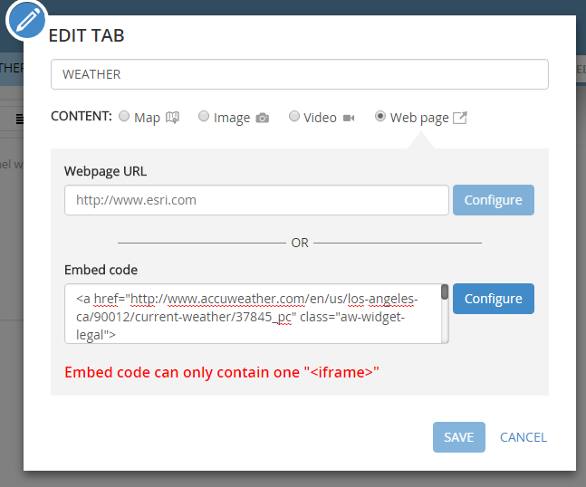

I've successfully added one widget to my Story Map but I cannot add a two Twitter widgets and a weather widget.

Hi Pricilla,
For adding the weather like that you can just add the URL that you have as your HREF property to the webpage URL box. The embed code is just for embedding code within an <iframe>.
