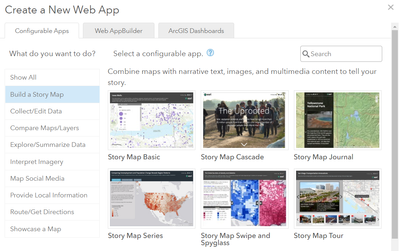

We're currently using ArcGIS Enterprise 10.8.1, and I have just created my first Story Map.  However when I started creating I only obtained one template, can only make very minor changes to formatting, and there doesn't seem to be any option to use a different theme (or to customize one's theme).  Does  this option not come with this version of ArcGIS Enterprise?
1) Where can I download blank Story Map templates that I can customize?
Or
2) Am I able to customize the theme using my current Story Map building in Portal for ArcGIS 10.8.1?
Thank you

Please check the storymap builders you get while sharing your webmap (Configurable App Templates).

Mark_Hotz
Jayanta:
Thanks for your help and suggestions.  I believe this worked...for some reason I must have been using a quick start type StoryMap template, and it wasn't offering me the options that your suggestions have.  But now I'm able to see the options and can edit and make it work.  I just have to learn more about it now to get better and creating a StoryMap on-the-fly as it were.
