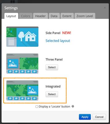

I am struggling to "hide" the opaque framing around the target photo in the carousel tour map story map.   I have tried making the hex color transparent to no avail.  If you look at the santa clara template ESRI shared on the classic story map site, the map frame itself extends across the entire page.   In the default design created by downloading the 2.14 template or using the AGOL builder the frame is blocking my map.    how can I hide/disable the frame, or enable the full map panel.   See attachments
 Please help!  I put in a support ticket, however this is out of support apparently and they referred me here...  has someone done this?
I will add this is a self hosted site.  I have been tinkering with the map-tour-config.json    where can we customize this option?

Hi @TonyBedogne -- To get the look that you want just go into Settings and change the layout to the "integrated layout."
