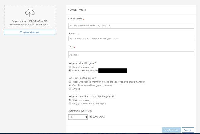

by Anonymous User
Not applicable
Hi Owen!
I am having the same issue. My coworker and I would like to edit the same storymap from our individual accounts within our organization. When I created the group, the fourth toggle question "What items in the group can members update" was not present   She is a group manager and I am the owner
Also - when I share the storymap (cascade) it only gives me the option to share with the public, my organization, or specific groups (it is shared with the group) but I do not have the option to share with access and update capabilities
Is there anything else I can try?
Thank you!
KateBerg2
I have the same question as Payten below, but her question wasn't answered. What do I do if "what items in the group can its members update?" isn't an option when I create a group?
OwenGeo
Esri Notable Contributor
Kate -- you need to be an administrator to create a group with update capabilities.
