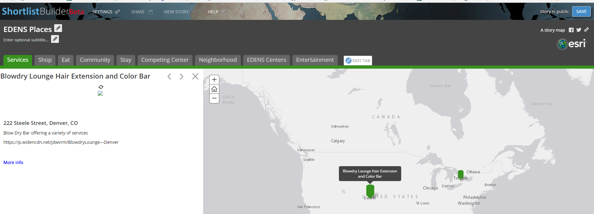

I am trying to create a shortlist Story Map. We have a photo service called Widen, which I tried using.  I added in the urls, but when i created the Story Map it didn't work.  I moved those URLs to a description field so I can use them later possibly if i find out it's possible.  That's why you see it in the screen shot below.
So I created a Flickr account and loaded them all into there.  The images are not displaying in the thumbnail or the main image. I am using a field called PIC_URL, and the publicly shared Flickr url is still not working it just spins.  When I right click on the spinning icon, and choose to open in another tab it opens perfectly.  This is my first story map, so I'm not sure what I'm doing wrong.  I've created and recreated several times, but no luck.
I downloaded the schema, and everything else is working perfectly.  I just can't get the pics to display.  Most are under 1mb.  a couple are between 1-2mb and there are a few over 2mb.

If you want to create a Shortlist by preparing the places in a layer in a web map, such as a feature layer or spreadsheet based layer (see FAQ about that), the fields that you use to specify the image URL for the large image and the thumbnail image for each place have to point directly at the image, not a page containing an image, which is the case with your Flickr URL BlowdryLounge - Denver | Elly EDENS | Flickr . That URL won't work because it is displaying a web page, not a single image. So usually the URL will usually end in an image file extension like .jpg.
To get the direct image file URL for any public Flickr image, see these instructions in the Flickr Help:Get the URL of a Flickr photo | Yahoo Help - SLN15714
So if you follow their steps, in Flickr you'll click Download > All Sizes and get to this page for the image above:
All sizes | BlowdryLounge - Denver | Flickr - Photo Sharing!
and you can then choose the image you want to use, and right click the image that appears to get the URL you need. For example for your image I would use the Small 240 image for the thumbnail:
https://c1.staticflickr.com/5/4596/38424203824_a8f8316a1b_m.jpg
and the Medium 640 for the large image:
https://c1.staticflickr.com/5/4596/38424203824_a8f8316a1b_z.jpg
I did try the original URL you tried for the image stored in the image system you mentioned:
https://p.widencdn.net/jdwrm/blowdrylounge---Denver
This returns an image that says Preview Not Available if I open that in my web browser, so if you include that URL in a Shortlist, that's the image that the Shortlist will also display. The URL works OK: even though it doesn't end in a file extension like JPG, it still returns an image file so the Shortlist will display it correctly: It's just that the URL you are using is not displaying the image you want.

CorryneBennett
Thanks for the info about how to grab the image not the page, that makes sense. I’ve already built the locations, web page links, and descriptions for over 400 points, so all the work is done. The last of piece was figuring out how to display the images. Thank you very much for your help I will give that a try.
