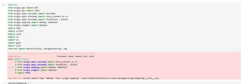

@ThePreatorian I am trying to convert a Cascade classic StoryMap!
This is the error I get - I attached a screenshot as well just in case the image is difficult to see:
I have VERY LITTLE background in python (and coding for the most part) of any kind - so I pretty much just paste the StoryMap ID in there, add my credentials, and have been hoping for the best! But I haven't been able to get the tool to work.
Thank you!
ThePreatorian
@SaraJLThanks for the screenshot! It was useful in debugging the issue. I attempted to fix the issue. And this should be live in the notebook now.
Please try it out again. It should work now.

@ThePreatorian thank you for taking a look! After playing a lot of catch up, I finally was able to come back to this - I downloaded the updated version, but I am still receiving the same error:
I came across this article - is it possible that one of the modules might be deprecated? I'm not entirely sure if that's the case, but was just looking around the forums for other details.
Thank you again!
ThePreatorian
@SaraJL Thats strange, where are you running this notebook? In AGO or locally on your machine. Two things are required for the new updated version to work on AGO.
1. Running the last cell to force install the 2.2 version of the ArcGIS python API
2. Set your notebook settings to use the 10.0 runtime
Alternatively, you need to pin your local python version to 3.10 and the ArcGIS package versions to 2.2.
If you keep running into issues please reach out through a DM to figure things out.
SaraJL
I'm running it in my AGO org environment! I made those settings - but now every time I try to run all cells, it just automatically skips everything, says the kernel is idle, and doesn't run anything. I'll send a DM.
