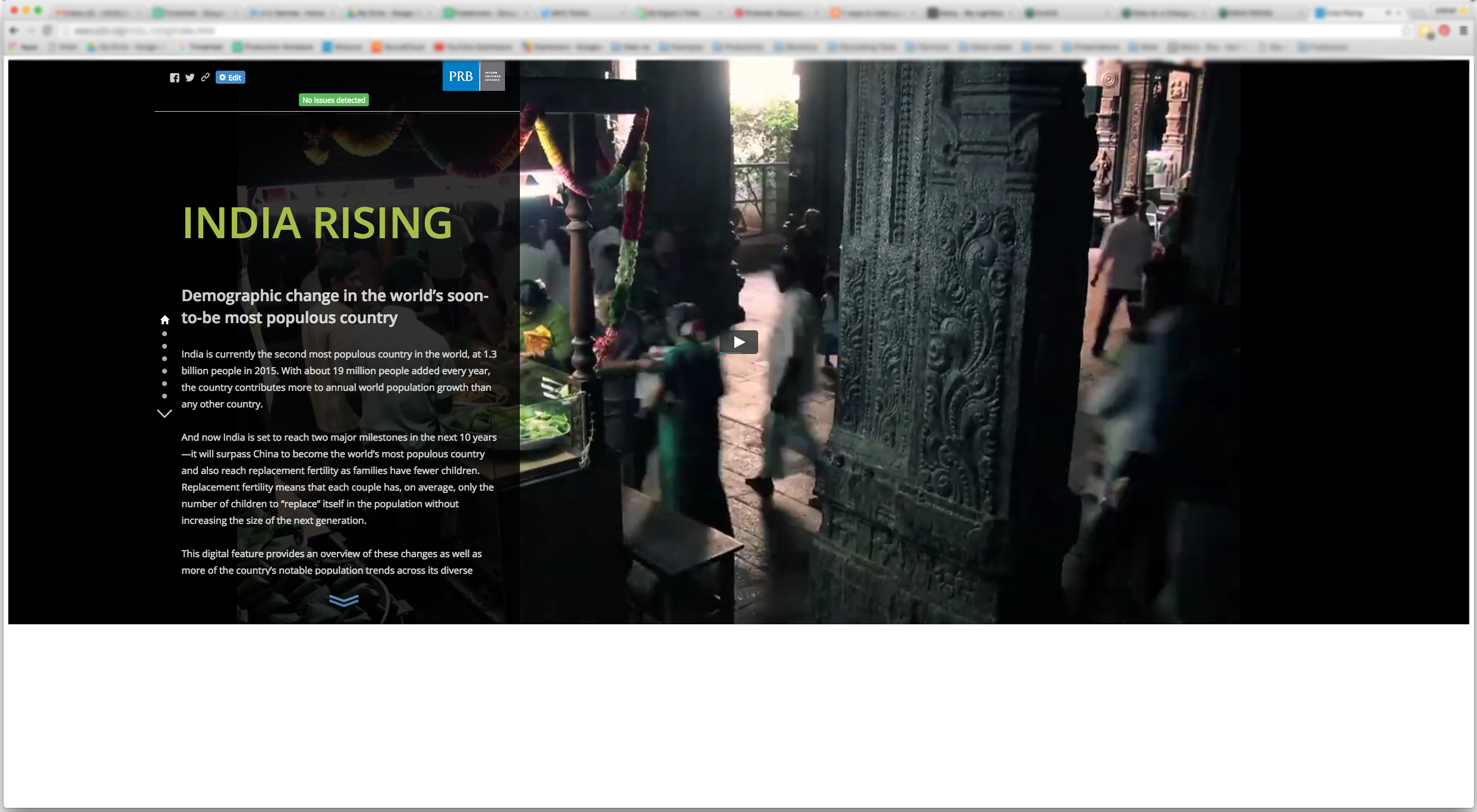

I have embedded a completed Story Map on our website, but instead of filling my browser, it leaves an empty white space below. It is filling 100% of the width of the browser, but not the height. I tried changing the embed code so that height was also 100%, but this did not work.
Solved! Go to Solution.
Tyjen, by default, most browsers add a small margin around the body content and the body of the page doesn't have a set height so the 100% height won't work. I've attached a new html page that should give you the results you are expecting. I've also added a few meta tags so your app will switch to the mobile version on smaller screens. You should also add fill in open graph tags and title so Google and other social media sites can understand your page better: https://medium.com/story-maps-developers-corner/grow-your-story-maps-audience-with-open-graph-tags-b...
Hi Tyjen - sorry you hare having trouble embedding your story map. Could you post the URL here (or private message it to me) so I can take a look? It's hard to tell what is going on from the screenshot. Is there anything else on this page or are you just trying to get a full page iframe with your story map?
Owen
Here is the link: http://www.prb.org/india_rising/index.html
Yes, we are trying to get a full screen story map. I'm not sure why it's not working for us, but in all of the examples on your gallery, it shows up as full screen for me:
Thank you, this worked!
