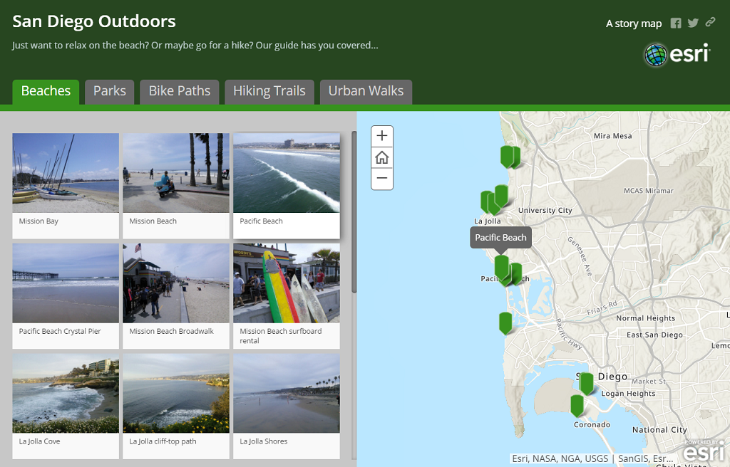

I've been working on a hosted app, and have already customized it by editing viewer-min.css. I have successfully added a custom banner, but I have been unable to find the settings on getting rid of or changing the color of the default grey bar behind the tabs (separating the header from the map/tab panels. Does anyone know what line(s) I would need to change? I tried "inspecting" on chrome to no avail.
I circled the grey area that I'm talking about to hopefully clear up what I'm trying to change.

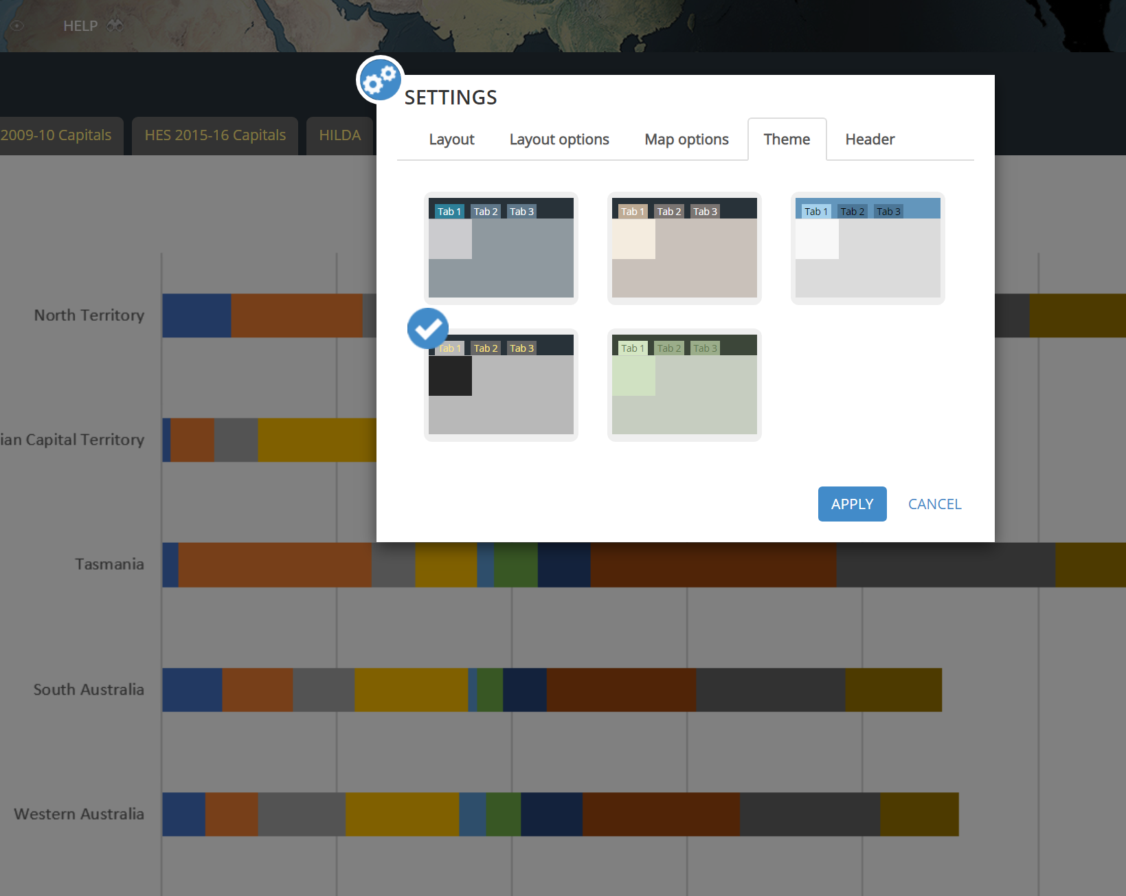

Hi Ian, in last week's ArcGIS Online update we added the ability to change the header color in the Story Map Shortlist Builder. In the Builder, see the new Settings > Theme tab. This changes the color of the header area, including the area behind the tabs:
Rupert

Can someone explain how this could be done in the current version of map story? I don't think there is any option change colors! see attached snapshot.No color change optionsp shot.
