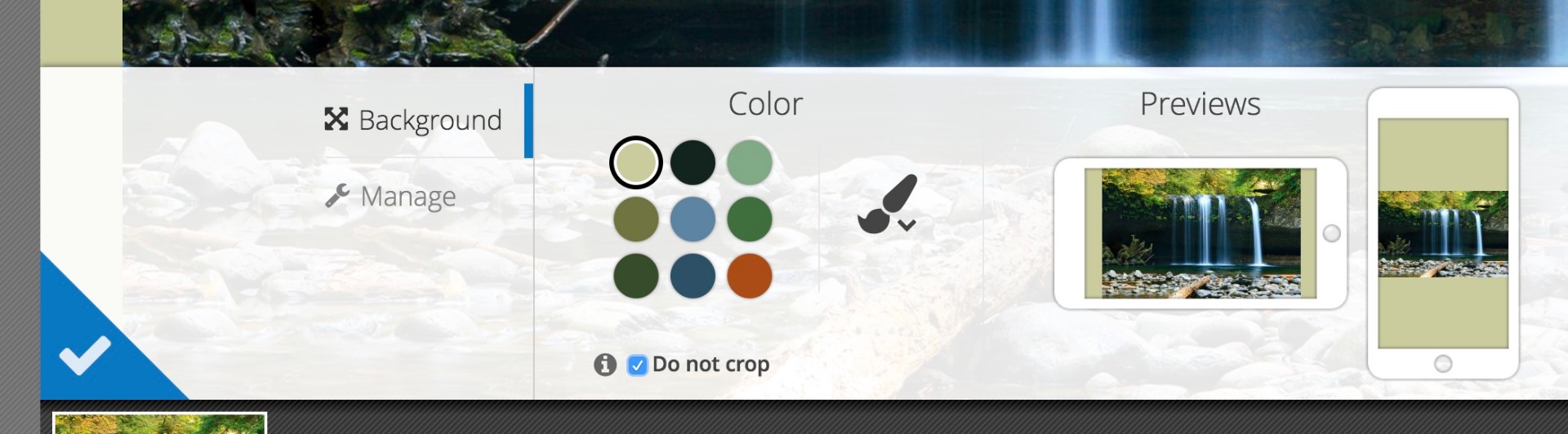

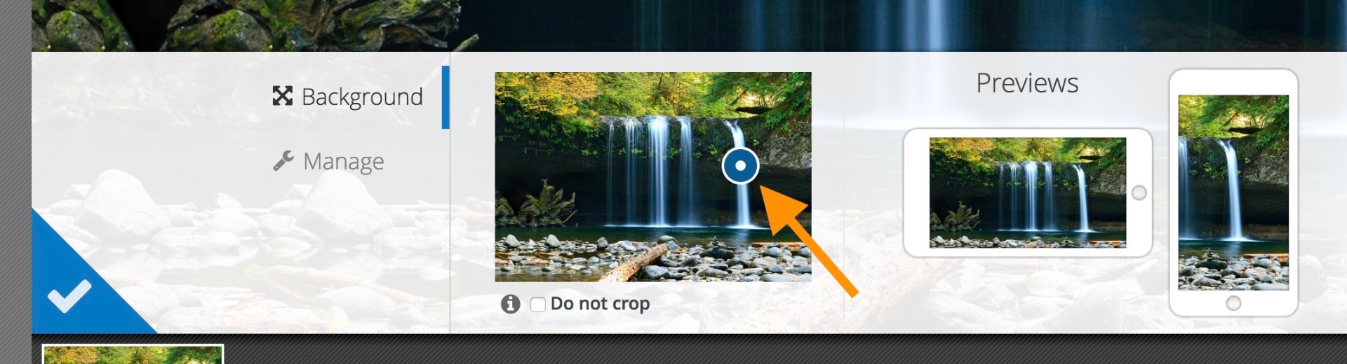

Hi Jennifer -- Sorry you are seeing differences in your Cascade story on different computers. This is somewhat expected since Cascade stories have a full-window format and screen dimentions, screen resolutions, and browser window aspect ratios can vary from computer to computer. Can you share a screenshot of what you are seeing?
If you have a photo that has words or other elements that you do not want to be cropped out you have a few options:
  • Use the image in-line in a narrative section as a SMALL or MEDIUM sized image
  • If you are using the image as a background image, either
    • use the focus point to ensure the important part of the photo isn't cropped out, or
    • choose the Do No Crop option
Below are screenshots of these three options. Let me know if these are helpful.
In-line (small)
Immersive background -- use blue focus point to mark the most important part of the image that you do not want cropped out
Immersive background -- use "Do not crop" option
Owen Evans
