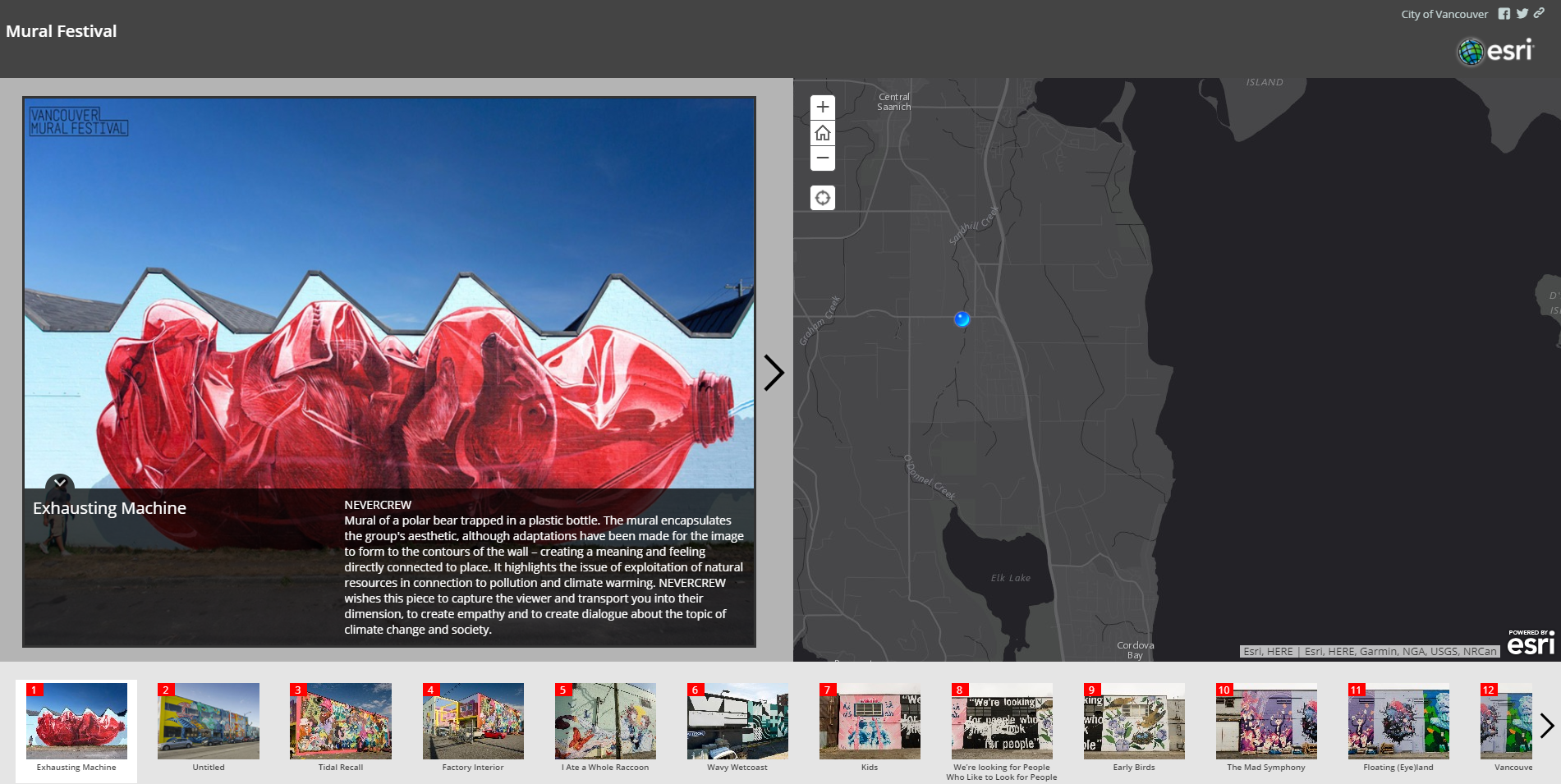

I am not able to bring the 'Locate' button on my map. I am using the AGOL hosted template "Story Map Tour".
Confirming the choice "Display a 'Locate' button" in Settings/Layout in builder mode does not work. I see this function  important for mobile users.

First check to make sure the URL to your story starts with "https." If the URL starts with "http," you are loading you story on an insecure connection. Modern browsers will not provide a user's location to a website unless the website connects using a secure connection to prevent a hacker from stealing that user's location information. Because of this, we disable the locate button when the story is loaded of "http." If you still have issues, let us know. Also, if you have a public link to your story, that will help us investigate if there is a bug in the app.

Thank you very much Stephen. This is the solution.
