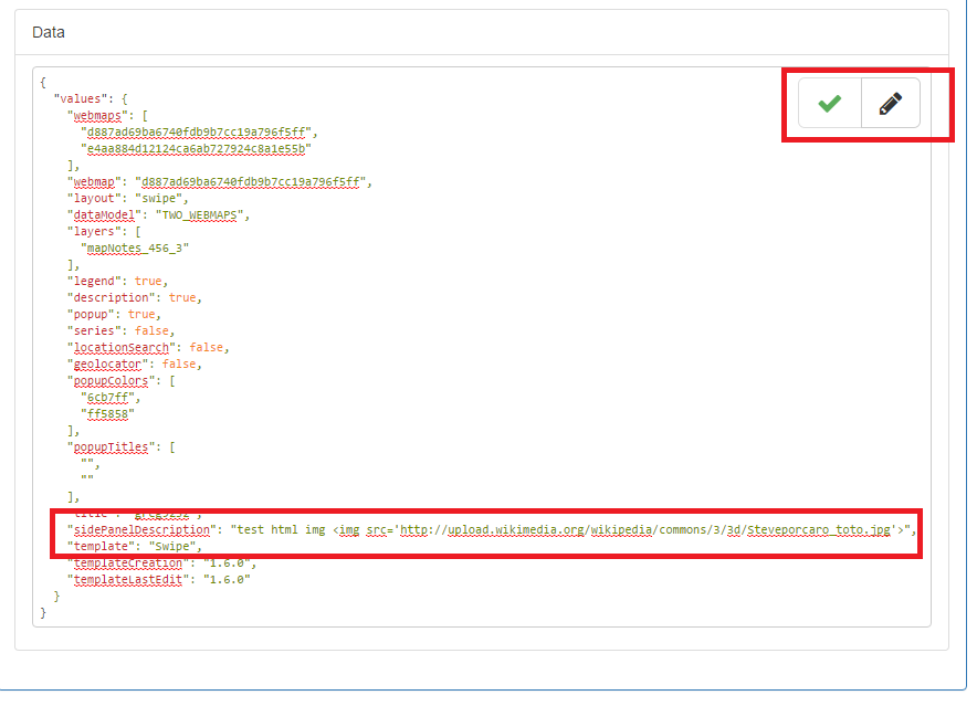

There is no way to include image in the description using the builder easily unfortunately but you can use the following tool https://ago-assistant.esri.com/​ to manually edit the application data. After the selection the application and clicking "I want to" > "View an item's JSON", scroll down until you find the description and insert your image using the img HTML tag. Then save using the tool in the corner.
Be very careful that tool can easily break your application
