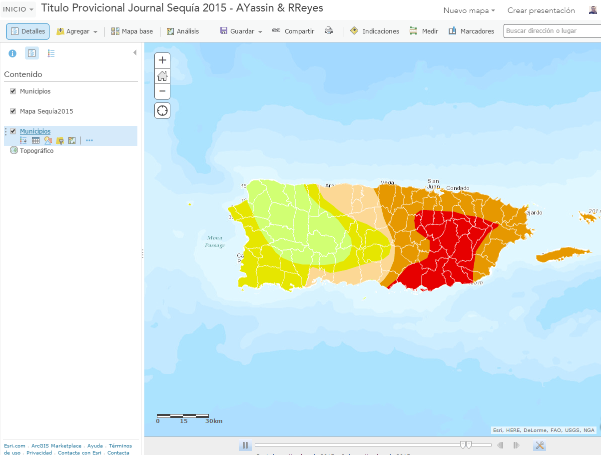

I have this really cool time animation map that shows drought in Puerto Rico in 2015
http://gmtcorp.maps.arcgis.com/home/webmap/viewer.html?webmap=e77f15ed6d504d828a7186080c9746a5

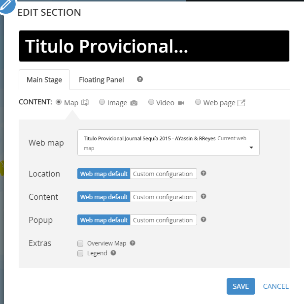

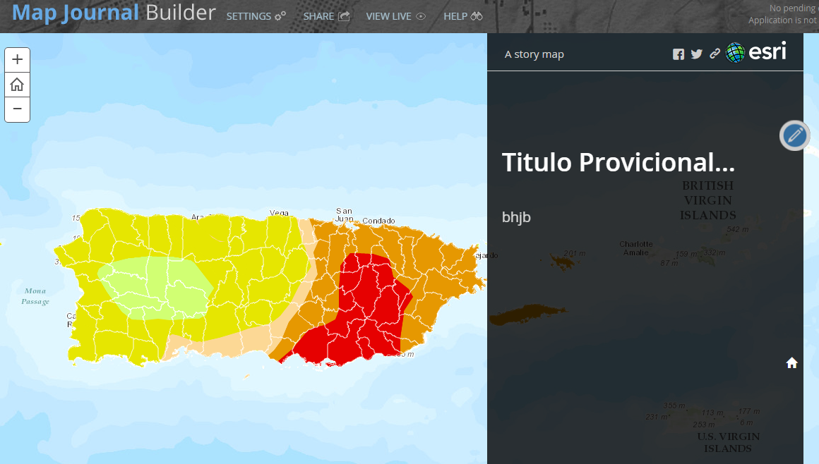

I am trying to create a Story Map (journal) and when I consume this Web Map
it stops been a dynamic map and is just a static map. Is this normal?
Do I need to add the url of my map like a URL content and not like a map content if I want to have the time animation functionality? is it the only way?

At this time the Map Journal app does not support time-enabled layers when you load a map into the Main Stage. The best way to accomplish this would be to publish your web map in the Time Aware template then embed it in the Map Journal as a web map. Here’s a blog post that explains the process: http://blogs.esri.com/esri/arcgis/2015/08/03/how-to-make-a-time-aware-story-map/.
