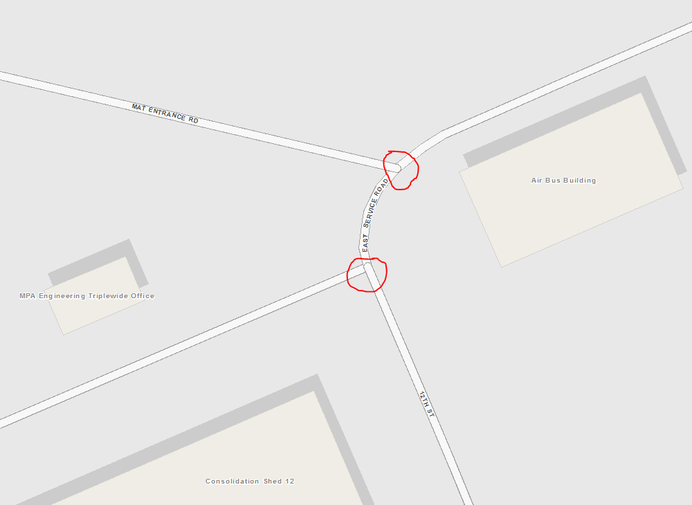

Hi,
I am curretnly facing a problem with my street layer for a custom basemap. The problem is that the way in which the streets layer is drawn creates an overlap with other streets (see attached image). Is there a way to fix/remove this? Overlap.PNG

Go to the ArcGIS Help and look up "symbol level drawing".  By setting symbol levels you can "merge/order/remove" boundaries for lines that connect to each other.
http://desktop.arcgis.com/en/desktop/latest/map/working-with-layers/what-is-symbol-level-drawing-.ht...

My organization has also created a custom basemap with streets and using Symbol Levels with Join resolved the same issue you were having.
