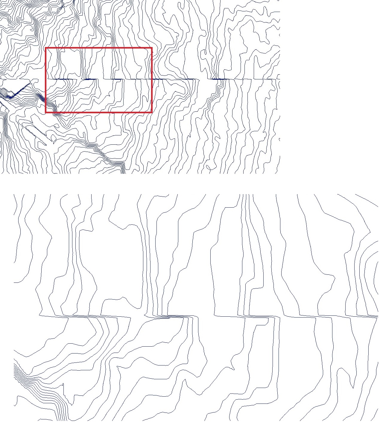

Thanks for your answer. I live in Quito Ecuador, South America. The point is that I got the contour lines from a DEM and the outcome came with errors like these ones:
Sampel of contour lines with errors
and now I'm looking the suitable way to correct them. The file is huge and the editing is terrible slow. We don´t have lidar for the total area, perhaps there are lidar information  from some scatered areas.

That is a common error that can be found in any situation where edge matching of contours (or any shape for that matter) occurs on the edges.  The projection of the data might be something like a UTM I suspect.  There is no way of auto-correcting what you see.  If you had the original DEM (ie point values, you could redo the contouring yourself.  If you simply have the raster, then any sort of filtering will just produce other artifacts.

The only way to get rid of the artifact is to re-contour the dem data with a fully stitched set of data.  However, if the DEM raw data shows that artifact as well, so will the contours.
You could try filtering the (smoothing) the original data, but that raises other issues.  Or you could try smoothing the contours, but that would be horrendous elsewhere.
Manual correction, if it is mission critical.  I have yet to see any solution that applies to all situations.

After seeing the image I am thinking that the DEM tiles were not edge matched properly in the first place.
DanPatterson_Retired
MVP Emeritus
I suspect the tiles were projected, then contoured individually.  If the data were in geographic coordinates, merged, then projected this artifact wouldn't show.
I have seen it with all our country's data ... thematic or contour, when maps are produced at various scales individually.  The 'seam' issue is common
