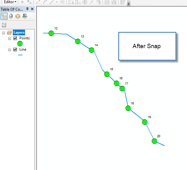

I am transferring locations from a paper map to ArcMap so that I can calculate the difference between locations. The locations don't have to be exact because the animal locations I am mapping can cover large distances. What I did to transfer the locations is create a road along the coast and then add points along the road. There seems to be a problem because the points are not quite on the road. Even when I zoom in really far and add points to the road they will end up a little off of it. I selected by location for points intersecting the road and less than 1/3 of my points for each map end up on the road. I am guessing that I should have been using the snapping tool all along. Is there anyway to snap retroactively or a different tool to add the point locations to the road? or do I have to start over? Thank you so much for your help!
MarkBockenhauer
You can use the Geoprocessing Tool Snap.
HeilaniMuehlman
Thank you! This was very helpful.
