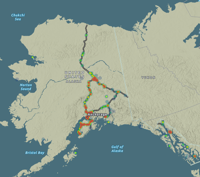

I am making a webmap that shows my point data as a heat map. On a broad scale, I want to display my heat map the way it is currently showing. See photo below.

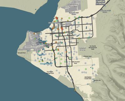

Unfortunately, I run into trouble when I zoom into a specific community, for example Anchorage shown below. I do not like the way the heat map is rendering at this scale, as it takes away from my main message that I want to convey to my audience.
Therefore, I locked my radius at the fine scale and I do like the way it is now showing Anchorage. See photo below:
Unfortunately, the trouble that I now run into is the broad scale, it no longer looks like the way it did before I locked my radius. See photo below:
