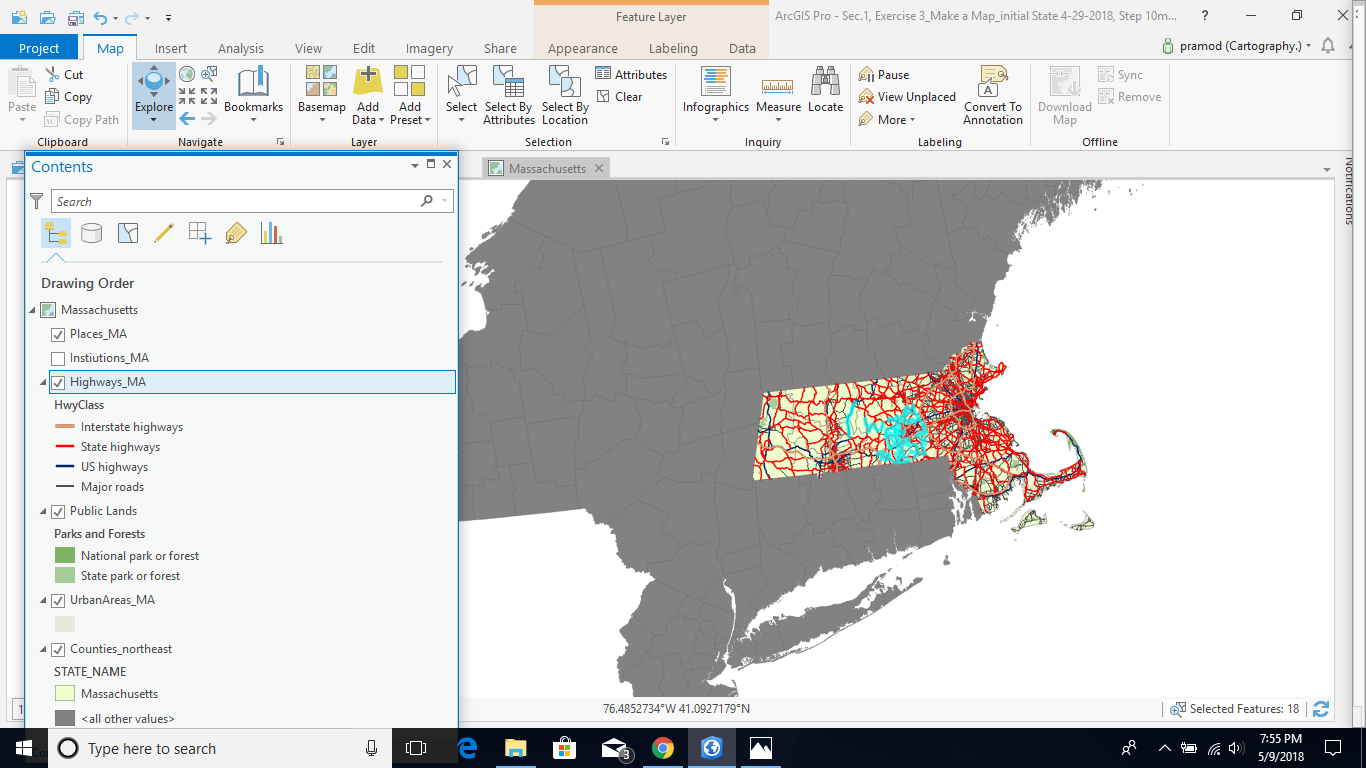

I have a question for the instructors: My Symbology Tab stopped workingMassachusetts Map

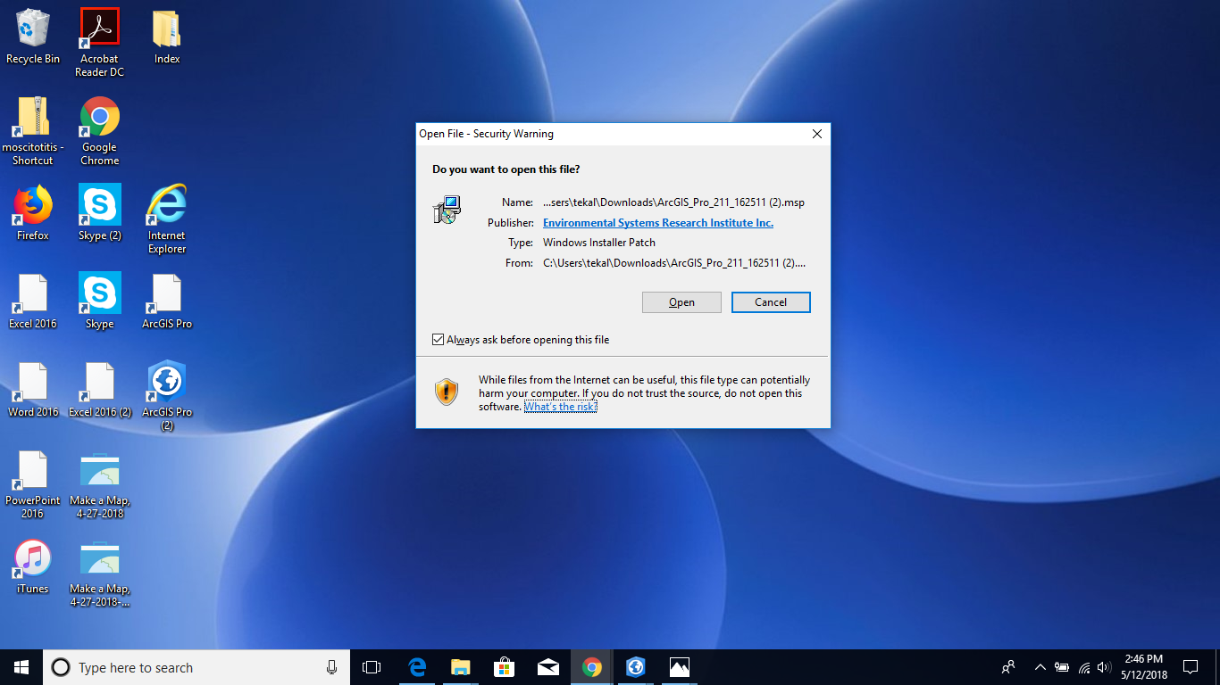

For example, under Highways_MA; when I click the symbol for Interstate Highways, nothing happens. When I am about to download the ArcGIS Pro 2.1 Patch 1 (2.1.1) and ArcGIS Pro 2.1 Patch 2 (2.1.2), there is a warning:
The screenshot of the warning is:
Warning Message #1
Also another  warning message comes; here is a screenshot:
File warning
Is this a risk to my computer? Can I open this file? Should I download the patches?Please guide me.

As for the installation, I think that warning is common for most installs and you can simply ignore it. If you do not trust Esri software, then do not install it.

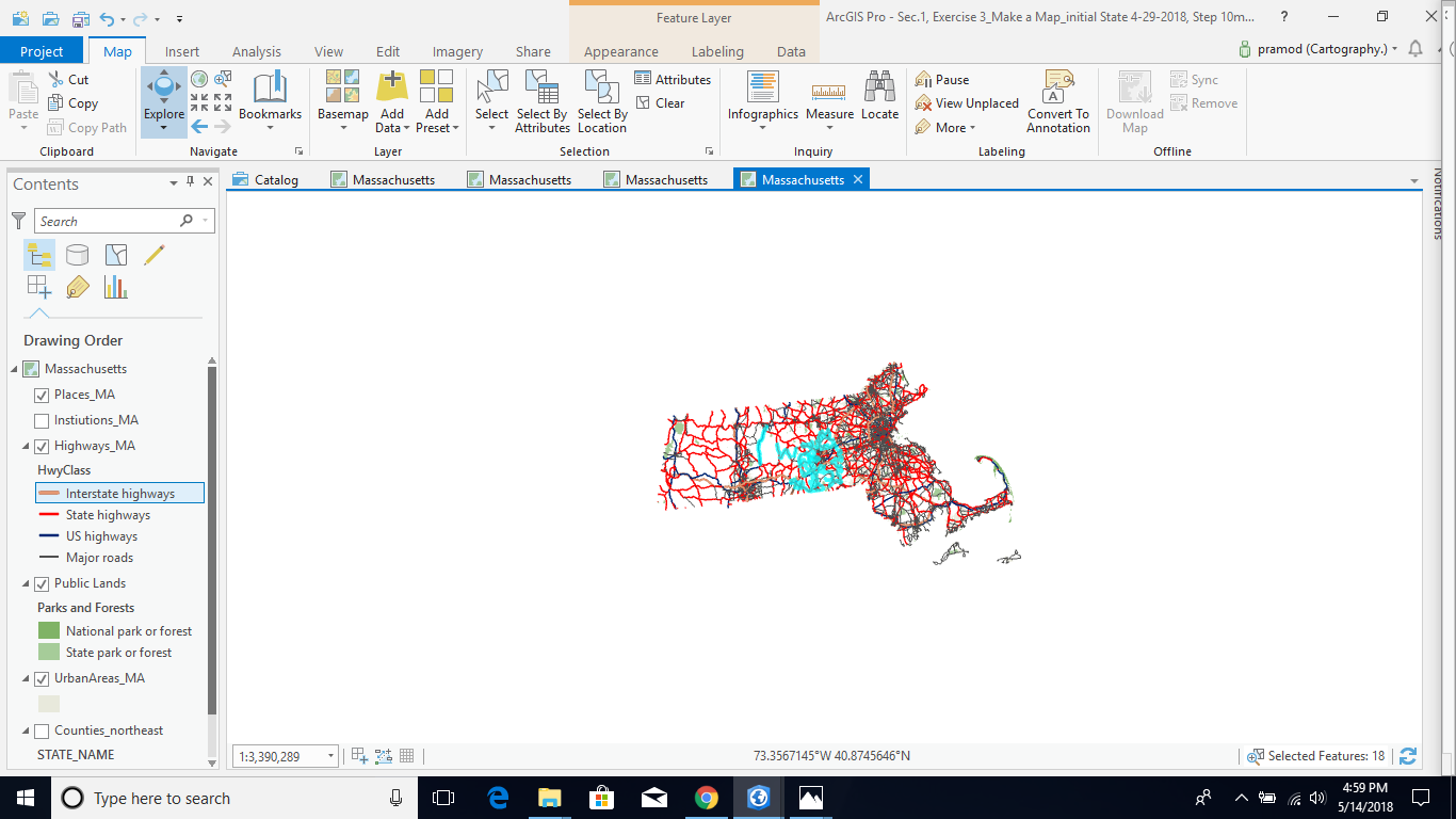

Thank you for your help. On the Symbology Tab, nothing happens. I right-clicked the layer and clicked on Symbology. It goes nowhere. The Appearance, Labeling, and Data under Feature Layer becomes lighted. Here is a screenshot:
Feature Layer
I am expecting to see the Format Line Symbol under the Symbology Dialog Box. Here is a screenshot:
Format Line Symbol
Please guide me.

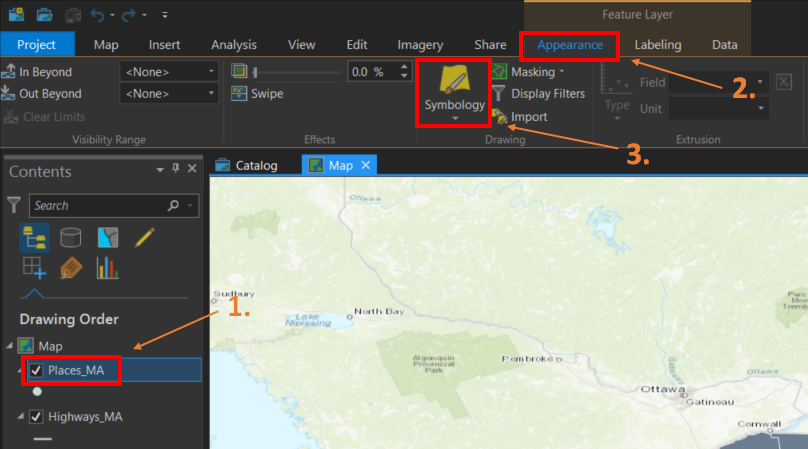

Try this. Click on your layer, the name of it (not the symbol underneath) and in the Feature Layer ribbon above, click on Appearance, and then click on Symbology.

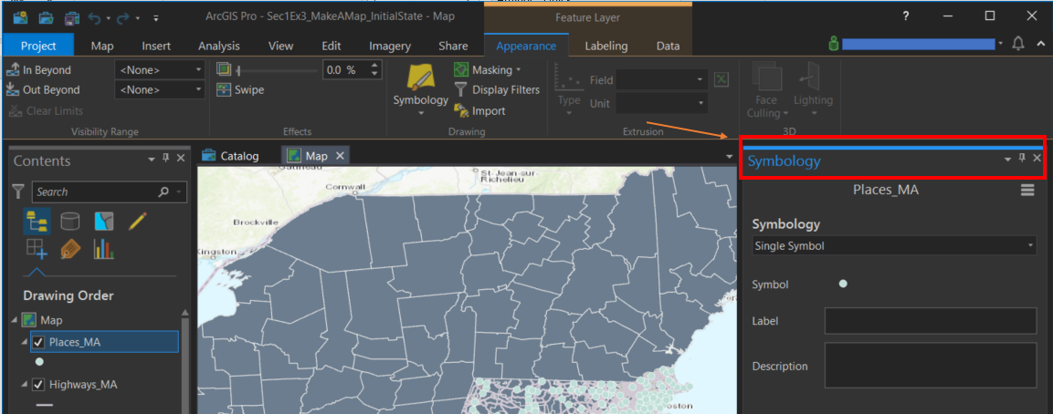

This should bring up the symbology pane on the right side:

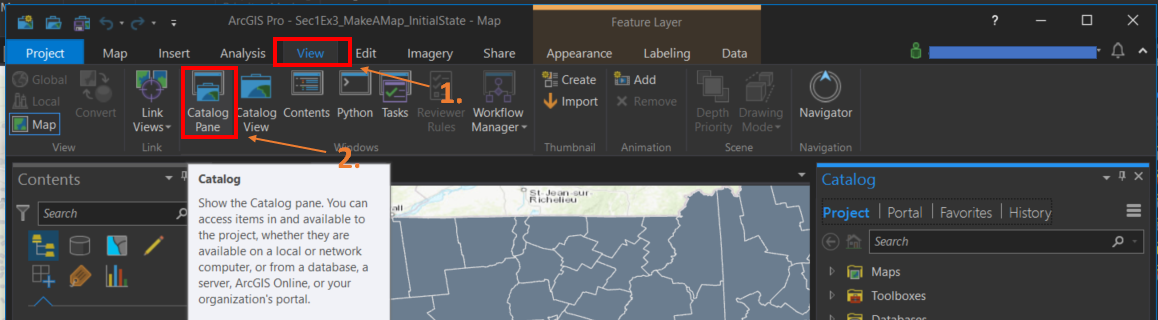

On the View ribbon bar, click on Catalog Pane. This should open up your Catalog pane which should contain your Symbology tab:
At the bottom of the Catalog pane on the right side, there should be a Symbology tab you can click on.
