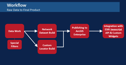

Building Custom Routing Technology
Going from raw data to a final product included much trial and error but included these overall steps:  data development, creating the network dataset and custom locators, publishing services, and custom widget development for user workflows.
Diagram of Custom Routing System Development Workflow
Data Preparation
Considerable data preparation occurred, starting with creating line features classes representing walking and biking routes. We used Arcade to populate a Name field based on other attribute fields (saving time and reducing errors), and other feature classes (sidewalks, building entrances, building outlines, parking lots) informed editing of individual route links.
Creation of the Routing Network
Route data was then integrated into a Network Dataset. This began by adding the data to a feature dataset, then setting a series of properties such as data sources, cost parameters and restrictions for each travel mode.
With network properties set, the last step was to build the network (a function within ArcGIS Pro) so that it can analytically solve routes. The tool was then tested using ArcGIS Pro to ensure correct results.
Creation of Custom Routing Locators
Custom locators were created to enhance user experience with specific route start and end points. Locators provide locations users choose from when searching for starting and ending points. Our custom locator merges three polygon feature classes (buildings, parking lots, open spaces) along with building entrance points, and was subsequently combined with the Esri world locator to create a composite locator covering geographic locations beyond the extent of ours. A locator for accessible routes was created as well.
Publishing Routing Services
After creating the custom network dataset and locators, we published them as services to ArcGIS Enterprise for use in online applications. This included adding the network dataset as a route layer to ArcMap and enabling network analysis when publishing. To publish locators, we used ArcGIS Pro, selecting the share locator option under the Share Ribbon.
Custom Widget Development for End User Workflows

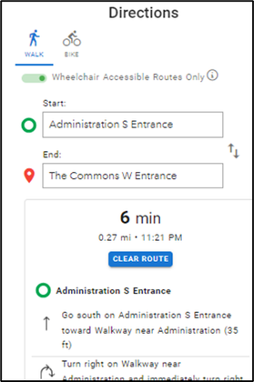

The Esri Javascript API was used to build a custom routing widget (refined user sequences,  design of UI elements) to optimize end-user workflows. When entering a location in the search widget or clicking a location on the map, this information is consumed by the custom locator to match addresses. Solved routes are then added to the map using custom graphics.
Custom Routing Widget

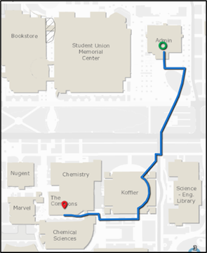

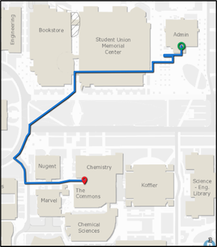

                                  A Walking  Route Solved                     Same Route Solved with Accessibility Filter

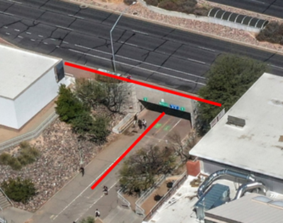

  • Elevation parameters were not enabled in creating the initial network dataset, resulting in route errors with underpasses and underground plazas. For example, an underpass sidewalk line intersected with a sidewalk line along the street above, so the user would be incorrectly switched from underground to ground level. The network dataset was subsequently adjusted to respect elevation changes.
Vertically Separated Route Segments

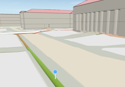

  • An immersive 3D user experience for viewing routes.
  • Incorporate route preference (such as shaded routes, routes near street lights).
  • Include a street network for use with the driving transportation mode.
  • Extend benefits of the routing system by deploying in other web applications.
  • Take the routing system indoors.
Immersive 3D Routing Prototype
