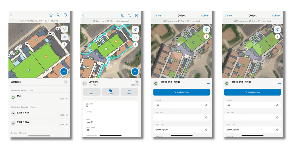

Field Validation & Mobile Editing
CAD-based conversions don’t capture everything. Legacy drawings often miss undocumented renovations, space reconfigurations, and asset changes. To address this, we conducted physical walkthroughs across 70+ facilities to validate the converted indoor data against current conditions.
To support this field verification, we integrated ArcGIS Field Maps with ArcGIS Indoors to deploy floor-aware indoor maps in mobile devices. Field staff navigated each level and visually compared mapped features to real-world conditions, while also validating architectural elements (walls, doors, rooms, stairs) and safety assets (AEDs, fire extinguishers, and other emergency equipment). Geometry corrections, asset status verification, and attribute edits were captured in real time and synchronized back to hosted feature layers in ArcGIS Online—streamlining field operations, reducing post-processing, and ensuring verified updates were immediately reflected across the enterprise GIS system.

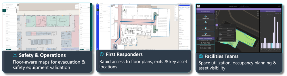

Building for Multiple Stakeholders
A district-wide Indoor GIS only works if the same authoritative indoor dataset can answer very different questions for very different stakeholders. We built the BCPS Indoors environment to do exactly that:
  • Facilities teams use the system for space utilization and portfolio decisions (including lease avoidance), occupancy planning by linking HR headcount to buildings/spaces, and asset visibility to support day-to-day planning.
  • Safety and operations use floor-aware indoor maps for evacuation planning and for locating and validating critical safety equipment (e.g., AEDs, fire extinguishers, emergency equipment).
  • First responders need rapid access to floor plans by levels, exits, and key asset locations through their emergency management system.
We published CAD-derived indoor GIS data to ArcGIS Online as web maps and services, then delivered the applications those teams needed: indoor map viewers, space planning tools, wayfinding/routing networks, and reporting dashboards.
