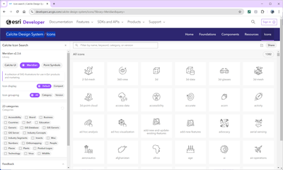

It's simple in the differente componet exist a value "icon", you can use any  name in all the list in your picture for insert in the componet selection. example
<calcite-button icon-start="2d-explore">Add layer</calcite-button>

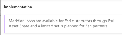

No, not include a url, possible the find in documentación  the wrong is a note in every icon. but I tried with "360-view" and implement display a icon.
<calcite-button icon-start="360-view">Add layer</calcite-button>
the error in console for a implementation  your suggestion
