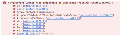

 HOWEVER: the following gets thrown to the console when the above line executes:
The DOM gets hydrated successfully and the radio buttons are fully operational.
I would like to get rid of this error, which is apparently buried in ArcGIS code. What can I do?
TIA
MattDriscoll
Hello! can you help us reproduce this error? I tried to replicate but i'm not seeing it:
https://codepen.io/driskull/pen/abeKZVy
