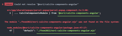

ForrestLin
I got error with @esri/calcite-components-angular now.
Cannot find module '@esri/calcite-components-angular' or its corresponding type declarations.ts(2307)
KittyHurley
Apologies, Calcite's 2.9.0 Angular build was incomplete. There will be an upcoming minor release in the near future, but in the meantime you could use version 2.8.6.
