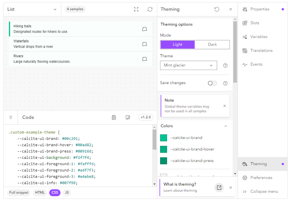

Also of note, just launched this week - component samples now include example themes to experiment with custom themes, including List. To enable in the sample, visit the sample's "Theming" section.
