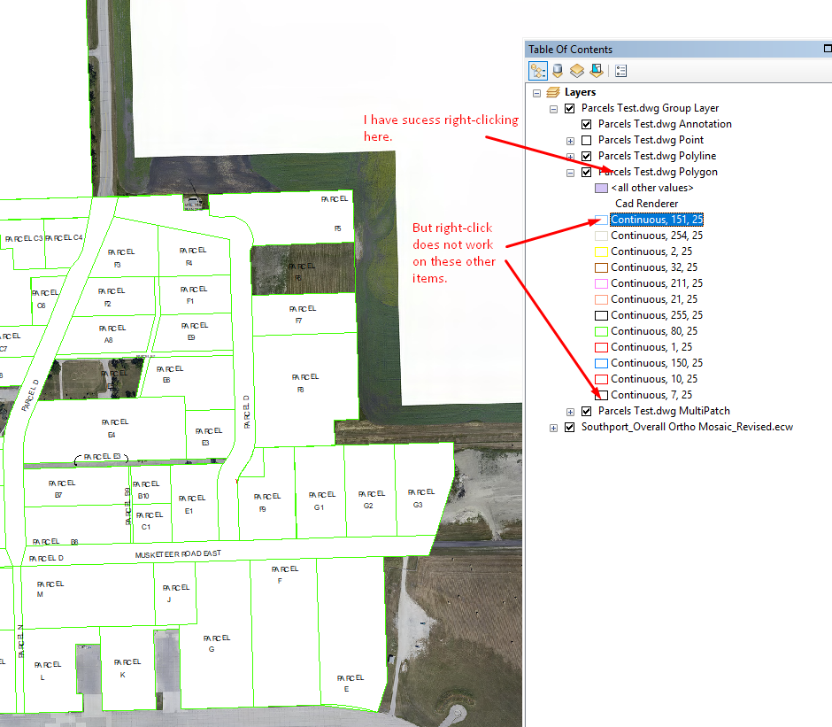

I've imported some CAD polygons, hatches, and annotation into arcmap using the Add Data tool. Once imported into arcmap, all of the colored hatches now appear white.Using the identify tool II am able to click on the various hatches. How do I changed the color of the hatches?

Thanks Adrian. That helps me get closer to my answer however when going through the steps it seems to turn on the hatches the same chosen color. I want to change different hatches to different colors. Any ideas?

Below is an image of the individual white shapes surrounded by green lines. It's the white shapes I want to change to different colors.

Try this, expand your layer in the table of contents (click on the little plus sign), then right click on the square that shows your symbol (in your case it will likely be a green box that's white in the middle). Then choose a new color from the color list that drops down.
If that doesn't work, open your symbology dialog (symbol selector), click on Edit Symbol, and change the color in there.
If there are still issues, please post a screenshot of what you see in your symbol selector.

It won't let me right-click on those items:

You may need to convert your CAD drawings into a geodatabase, then mess with the symbology.
Using the CAD To Geodatabase tool—Help | ArcGIS for Desktop
