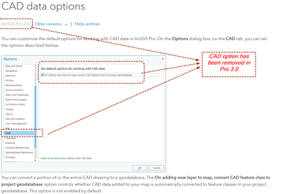

Hi, I´m astonished that the ability to automatically convert CAD drawings to geodatabase in Pro 3.0. has been removed. Why? It makes my everyday work unnecessary more complicated.
Or do I miss something here?

It seems that the CAD option has been removed in 3.0
Here is the 2.8 equivalent which I can't find anymore. https://pro.arcgis.com/en/pro-app/2.8/help/data/cad/cad-options.htm

You can use the GP tool - CAD to Geodatabase - to complete the same workflow of converting CAD files to a geodatabase
jtermaaten
We noticed the same behavior, sadly. After some discussion and research with Esri, an enhancement request has been created to reintroduce this in a new version. It is connected to the bug ENH-000153059: ArcGIS Pro 3.0 does not have the option "On adding new layer to map, convert CAD feature class to project geodatabase"
