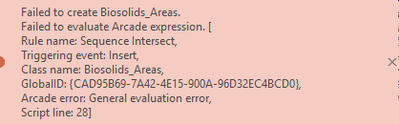

The issue I'm having is  general evaluation failure when trying to execute the rule upon an edit as formatted below. The expression validates and saves without issue however. I know everything up to and including line 24 is working as we get th expected "s011" value which should match the sequence name/ID.

Well...this was a classic case of user error. It helps if you create the database sequences in the correct database. Once I created the test sequences in the appropriate geodatabase...it worked like a charm. Thanks folks!
