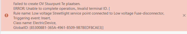

Hi,
this is my attribute rule. It seems to work fine, but i can not set the right terminal. I tried different things but I get always errors.

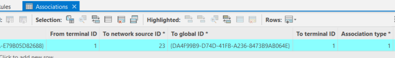

I get a association without error but, I have topology errors and the terminal is set FromTerminalID 1 ToTerminalID 1

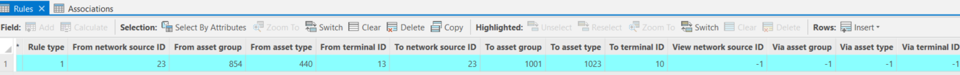

The association rule looks like this:
