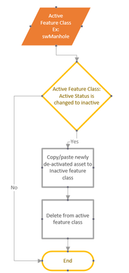

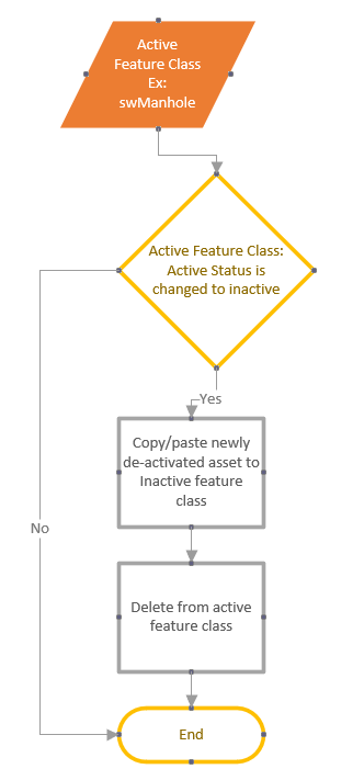

Hello all- I am working to set up our attribute rules. I would like to create a rule that will copy/paste an edited row of a feature class to another feature class when there is a status change from active to inactive. this is an example of what I think the flow would look like:
I did find a couple of examples where you can update a related table when a feature's attribute is changed, but haven't been able to find anything where I can trigger a copy/paste from one feature to another.

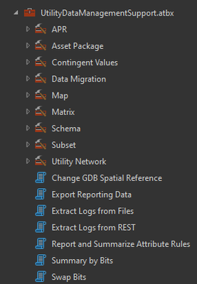

I downloaded the toolbox, but I am not seeing the Attribute Rules toolbox? I looked through all the toolboxes and tools just to make sure I wasn't missing something?!
Thanks for your assistance on this one.
MikeMillerGIS
Esri Frequent Contributor
We recently moved the tools to their own toolbox.  I will work on getting a copy posted for you to test out.
