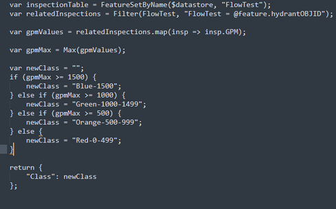

Line 1: You FeatureSetByName should have a list of fields passed as the third param
Line 4:  relatedInspections.map,  I do not know what that dies.  That is a FeatureSet.  You should call first or loop over the featureset and get a list of all the GPM Values.  Then you can call Max on it
Your return statement, just return the value.  If you set the rule on a field, it will map it to the field

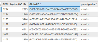

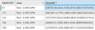

I have tried to implement the referenced script, and I don't receive any errors but it doesn't update the parent table. I'm not sure if I've made a mistake in the code or if it is my data setup. I have tried the relation ship class with GlobalID to GlobalID, Global to GUID, and the original ObjectID to hydrantOBJID.
Parent Table:
Related Table:
Code:

The code is using parentglobalid, but in your screen shots that is blank.  You need to adjust the code and the sql statement in the Filter(FeatureSet...) to match how your data is set up.
