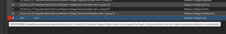

Hi,

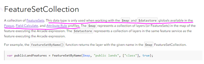

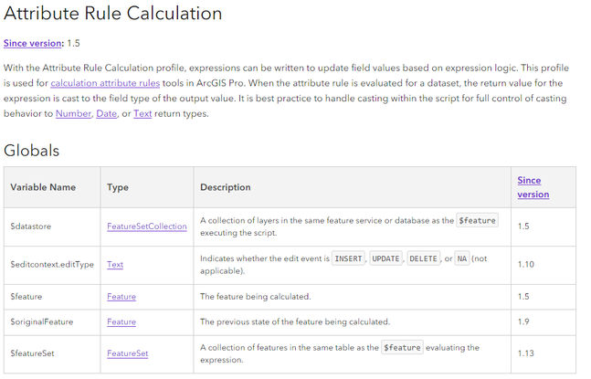

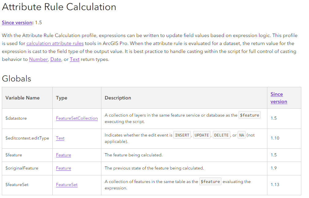

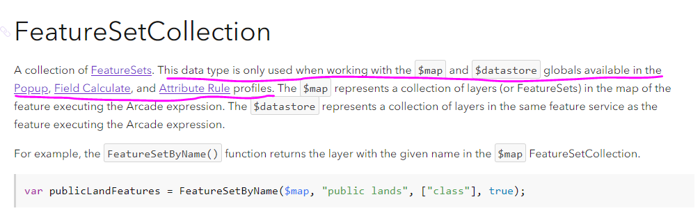

I'm getting this error when trying to save the rule (error and code images at the end) to my enterprise geodatabase (Utility Network in SQL database). The problem seems to be related to the code in the rule because I could save other rules with different code after the error. I think it has to do with my using the $map global in the Attribute Rule Calculation profile. The Arcade documentation is a little confusing about using the $map global in this profile. In the Profile section of the documentation (Profiles | ArcGIS Arcade) it doesn't include the $map global, but the Type System FeatureSetCollection section (Type System | ArcGIS Arcade) of the documentation mentions that the $map global can be used in the Attribute Rules profiles.

Yeah, it's the $map global. The documentation could be clearer on that.
Think about it this way:
Attribute Rules are executed on the database level. The database knows the tables it contains (so it has access to $datastore), but is has no clue about the context in which you are currently using a featureclass (so it has no access to $map).
Popups are executed on the application level. The application knows about the database the queried featureclass is in (it has access to $datastore), and it also knows about the context in which you're using the featureclass (has access to $map).
Have a great day!
Johannes
