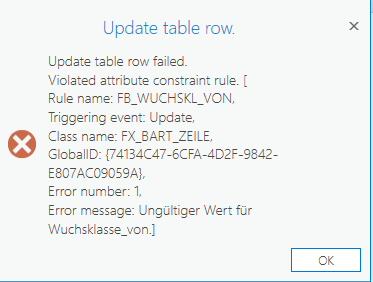

I have question regarding the message dialog for the constraint Attribute Rules in ArcGIS Pro:
Is this somehow configurable? The current output (see below) is very technical and will be probably not understood by our end users.
We would like to - for example - just show the error message we defined for the constraint.
Unfortunately I could not find anything in the documentation. Is that possible? Could anyone give me a hint on that, please?!

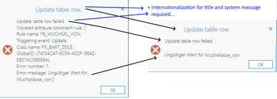

thanks for your reply! I am using AGP 2.8/2.9 and my question was not *how to define* an error in a constraint attribute rule, but if it is possible to configure the error message *dialog* shown above! Is it possible to make AGP just to show the error message of the constraint attribute rule without the technical information?

I did read the technical article, but my point is not how to configure an error message for a attribute rule constraint, but how it is presented in AGP. Maybe the following picture can make my point clearer. The mockup on the right is the way, I would like to configure the dialog to be shown in AGP:
