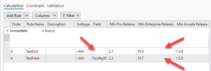

Also, when returning a dict, there is no need to choose a field in the AR pane.
However, there is a bug, and if you want to use this data in ArcGIS Server less than version 10.9, just populate the "Field" box.
As you can see by the minimum version required.  The ONLY difference between these two rules is that I picked the FacilityID field in one.  However, it will still populate all the fields in the result dict.
