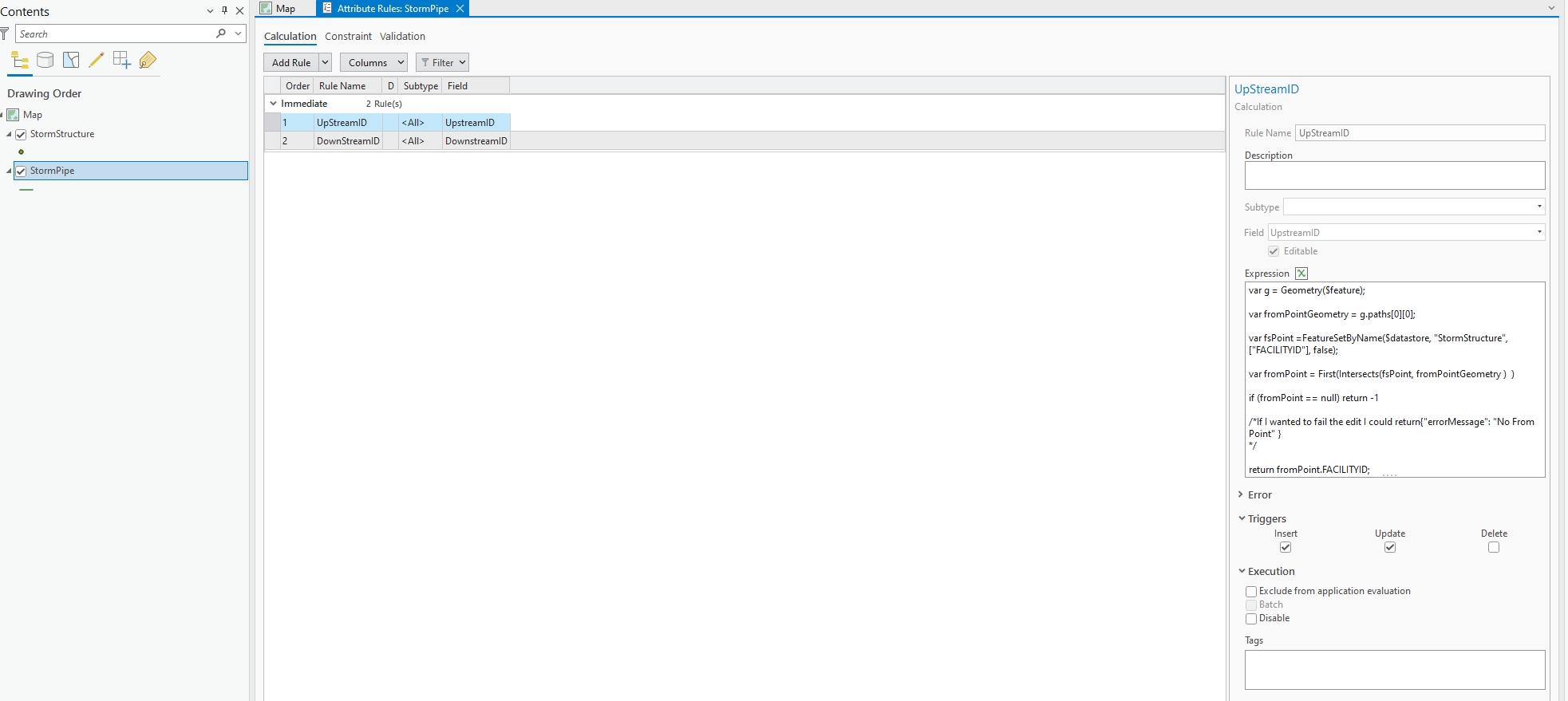

Hello all, I have created a geodatabase for storm structures/pipes and want to have the pipes automatically calc some fields based on the points they are connected to. I have successfully written the attribute rules to do this and they work fine in arcgis pro. However, when I share them to arcgis as a feature layer and draw a pipe in the map viewer, the popup does not show the id calculated.  I started to go down the road of pop-up configuration/attribute expressions, but isnt that what the AR is for? Also, the arcade expression in the AR doesnt work in the Attribute Expressions so i figured I am going about this all wrong. Help?

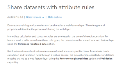

Dang, That's not what I wanted to hear! lol This article says differently (i think) but sounds like you have experience and know that its not the case.  This would be a game changer for our workflows if this would actually work.
https://pro.arcgis.com/en/pro-app/latest/help/data/geodatabases/overview/share-datasets-with-attribu...

You can, but you need ArcGIS Enterprise and an enterprise database.
JeraldAllen
Ah, that makes sense.. Thanks for the response!
