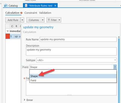

We don't recommend using DML to update the same feature, that will trigger further attribute rules and will end up in a cycle (shouldn't crash though)
In 2.7 we have introduced the ability to assign "SHAPE" field as a target field so you can update the feature's geometry directly. That is the recommended way.

unfortunately since this feature went into 2.7, it can only be used alongside 10.9.
Publishing a class that you assigned geometry to a 10.8.1 or earlier will fail to start the service since that feature doesn't exist in old releases.
You can however use and test this on client side in 2.7 (filegdb or client/server enterprise)
