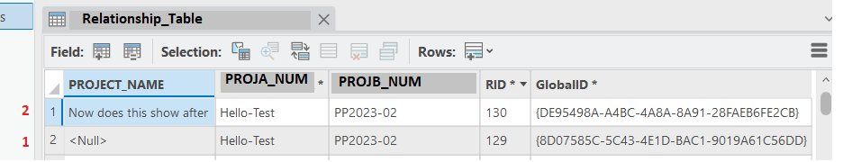

Hi everyone,
I have an attribute rule applied to fire whenever there is a new project from Project A that intersects with a project from Project B. This is applied with the 'update' trigger only, and not upon 'insert' and 'update' as it would generate a duplicate record, one for when the polygon was created, and another when attributes were created in the latter circumstance.
Here is a screenshot of the relationship table that I am updating via attribute rules.
In the screenshot above, RID 129 was created first when I created the Projects A polygon and populated a few attributes which is what I want.
RID 130 was created in the table after, when I updated a project_name in the same Projects A polygon.
Is there any logic I could incorporate into my attribute rule arcade script that would check for values in the relationship table and just update the existing record upon update, and not generate a whole new record/row in the relationship table every time a polygon is updated? The relationship table only has those few attributes that I have shown in the screenshot.

var payloadUpdate = [];
var c = 0;
var getPrpjNum = $feature.projb_project_num;
// Filter the Relationship_Class table to get the related records that match the Project Num of the new feature
var relatedRecords = Filter(relatedRecFs, "PROJB_PROJECT_NUM = @getPrpjNum"); //
if ($editcontext.editType == "INSERT"){
  for (var proj in fsInt) {
    payloadInsert[c++] = {
      "attributes": {
        "PROJB_PROJECT_NUM": $feature.PROJB_PROJECT_NUM
  return {
    "edit": [{
      "className": "Relationship_Class",
      "adds": payloadInsert
if ($editcontext.editType == "UPDATE"){
  for (var rec in relatedRecords) {
    var recGlobalID = rec.GLOBALID;
    payloadUpdate[c++] = {
      "GlobalID": recGlobalID, // this is the GlobalID of the related record
      "attributes": {
  return {
    "edit": [{
      "updates": payloadUpdate
This is the relationship class table, where I want to pull in or 'call' the PROJA_PROJECT_NUM and PROJECT_NAME from Projects_A in the above script, without getting the 'Dictionary Type expected' error when creating a polygon.
