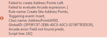

The schema I use for the ADMS solution is different to the one that comes out of the box, but when I define variables for attribute fields that I would like populated for the attribute rule "Create Site Address Points," they always come back as object not found.
For example, here are the variables I would like to add under the "Define the Site Address fields" portion of the code:
// Define the Site Addresses fields
//existing
var addressptid_field = "addressid";
var addrnum_field = "housenumber";
var roadfullname_field = "fullname";
var status_field = "status";
var defaultstatus = "Pending";
var addrcapturemeth_field = "capturemethod";
//additional
var predir_field ="predir";
var streetname_field ="streetname";
var sufdir_field ="sufdir";
var suftype_field ="suftype";
var unittype_field ="unittype";
And here is the original vs updated code I have tried to use to populate these fields

 Push(adds, {
     'attributes': Dictionary(addressptid_field, id, status_field, defaultstatus, addrnum_field, addrnum, roadfullname_field, intersectingRoad[fullname_field], addrcapturemeth_field, $feature[capturemeth_field], predir_field, intersectingRoad[predir], streetname_field, intersectingRoad[streetname], sufdir_field, intersectingRoad[sufdir], suftype_field, intersectingRoad[suftype], unittype_field, unittype),
    'geometry': newPoint
 addrNum += increment;
 Any ideas as to what I am doing wrong here? @ChrisFox
Thanks!
5 Replies
TedHoward2
Have you defined "unittype" further up in the code? Might help if we can see the whole attribute rule and screen shot of the error.
masslc
So the first thing that gives me the error pertains to variable predir. Here is the original full code:

At line 18, I'd like to add these variables which reference columns of my attribute table for the Site Address Points:
And then update line 229 to have them auto-populated per site point, like this:
// Create an array of 1 or more new site address point as specified

Now I am not getting an error, which originally was: Arcade object not found (predir). However, the fields in the attributes are not populating with the information requested when I create the site address point.
Thanks for your help!

masslc
Thanks for spotting that, I updated those and got my original error again, attached below.
TedHoward2
I think you need to reference how the Dictionary function works in Arcade. The rule builds the attributes payload using this function and you need to provide the field name followed by a value that you want inserted into that field. The value has to come from somewhere.
If intersectingRoad featureset does not have a field named "predir", then I would expect that error. Is it supposed to come from $feature? It's unclear what you are trying to do.
