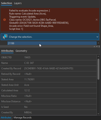

I have a script that regularly copies our parcel feature class from our parcel fabric from our editing database into a separate enterprise Geodatabase that users access for viewing parcels. Unfortunately, it also copies over the attribute rules which give you a big error message any time you are looking at the Attributes window in ArcGIS Pro on the newly copied layer:
Gong from sde to file geodatabase apparently renames the Shape_Area field to Shape.STArea() for some reason. I don't really care about that, but our attribute rule that automatically calculates the acreage does. That rule is not necessary on the copy of the parcel data, however, because the calculation has already been done by the time it reaches that point. To my knowledge, there is no way to exclude attribute rules when exporting it. You have to run a second tool "Delete Attribute Rule" after the fact. That seems pointlessly complicated when there are already environment settings that allow for similar things to be controlled when exporting. I would imagine just a simple checkbox that allows you to exclude attribute rules from the export is all it would take.
MDB_GIS
