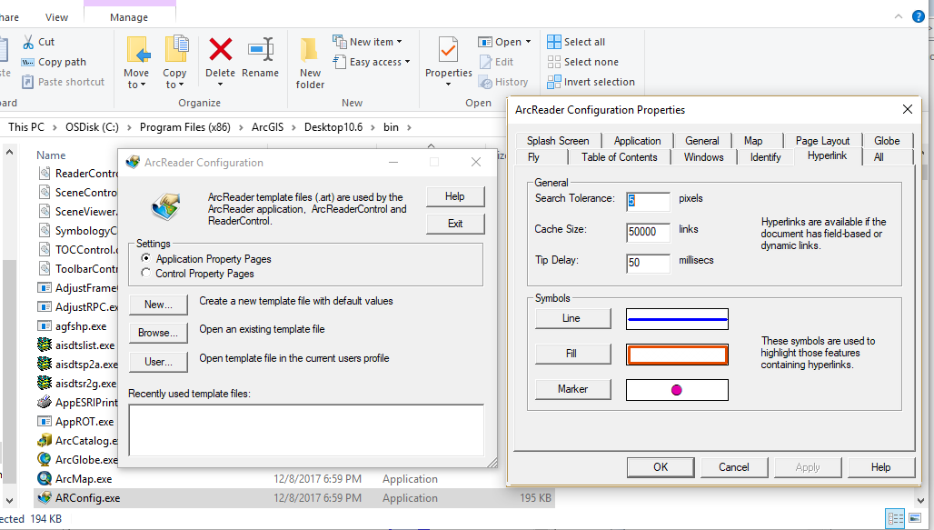

Yes, you can control the color using an ArcReader template.   ".art" file.
In your install location   Desktop<>/bin folder there is an ARConfig.exe
You can use it to create a .art file.
It has a lot of setting, but on the Hyperlink tab you can choose the symbol that you want ArcReader to use for displaying the hyperlink highlight.
Then when you publish the map in Publisher Setttings load the .art file you created.  This information will be included in the PMF and ArcReader will display the hyperlink with the chosen symbol.

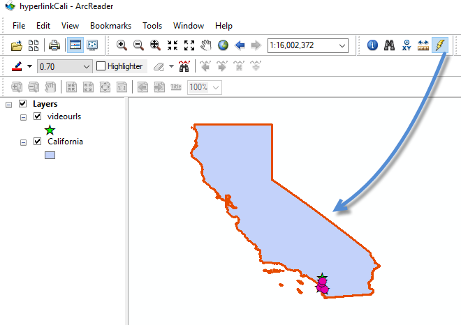

Thank you for the tip! Can you also tell me, is there an option to add a tool? I just want a way to turn off the hyperlink highlight after I’m done using it. There’s no Select Feature arrow?

The hyperlink highlight will be on when the Hyperlink tool is active.  If you click another tool, like measure, identify or any of the Pan - zoom buttons the hyperlink highlight will turn off.
