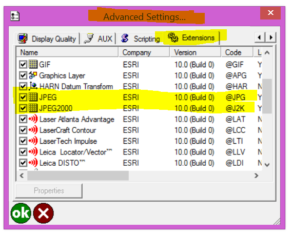

Robert,
You may need to go into the Advanced Options and check on the check box for viewing jpegs or other such images. This is in ArcPad.
HannahFerrier
Deactivated User
I agree with Adrian, the extension for JPEGs may not be switched on in ArcPad.
