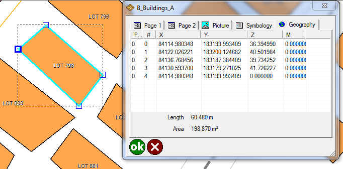

Hi, I want to get an extra explanation the reported errors below. The confusing here is that the polygon on ArcPad looks fine and close properly. Can anyone help?
1 out of 1 AXF files were processed.  Here are the results:
* The selected layers in C:\Users\gdasgdbadmin\Desktop\yusuf\AF44064_afterSync\DataForArcPad\DBO_FieldworkGroup2_KC2_4_5K_gdasgdb.axf were successfully checked in, but one or more edits were skipped because the geodatabase reported an error. The first error reported is:
Polygon does not close properly
The following XML document lists all ArcPad edits that were replayed against the source geodatabase.
Please click the ? button and then click this report for more details about the XML format.

HannahFerrier
Deactivated User
This is a known issue in ArcPad - the z-value for the closing point of a polygon is not set correctly.
This can be worked around by manually copying the z-value for vertex 0 into the z-value column for the last vertex.
Now for the good news - this issue will be resolved in the next ArcPad update, so your workarounds will only be temporary
Hannah
